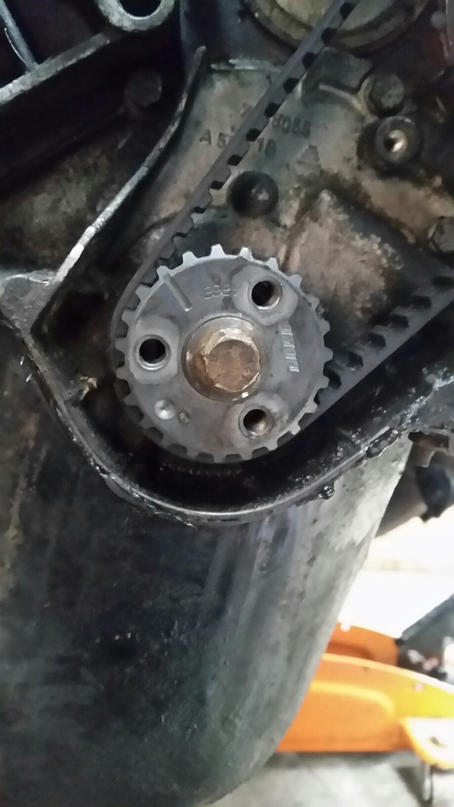

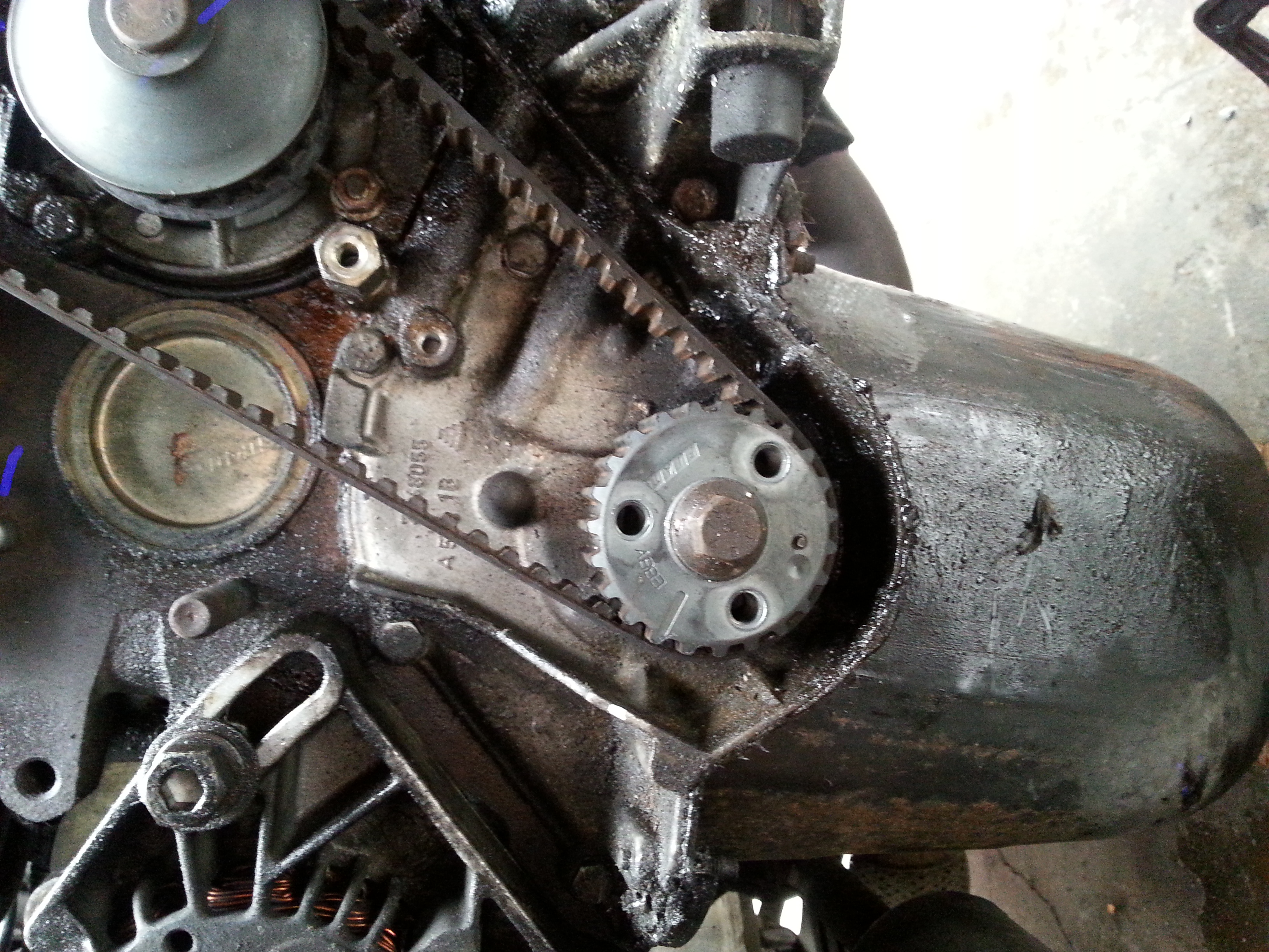

I came across some pictures I took when I changed the timing belt and water pump last year, so I have attached the 2 pictures of the lower pulley - one when it was timed correctly, and one when it was timed incorrectly by a garage (taken last week).
It might be useful as a reference for somebody to show that just one tooth out doesn't look much but made a hell of a difference to the performance.
