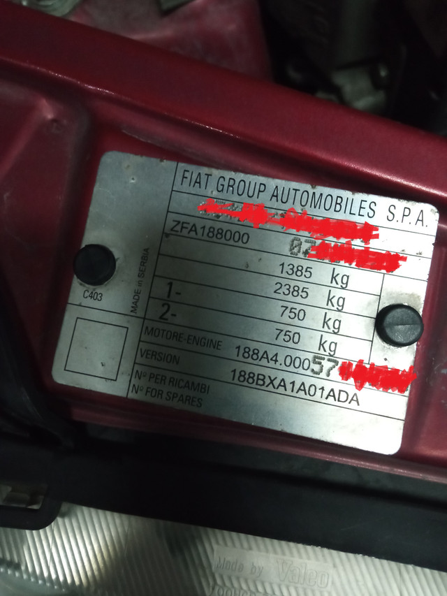

I will take a photo of my own engine card, to avoid some confusion.
"Engine Codes: 169A4.000, 199A4.000, 188A4.000 (EVO2 only), 350A.000"
So note what it says there "188A4.000 (EVO2 only)
The cam kit does a range of engines
the evo 2 uses the half bone and the plate across the back of the cam shaft in the groove"
And the thread is a guide for the timing using tools
and you can see in the guide the cam sprocket bolt is as Koala described for the later engine. and the crank sprocket has the same part number:)
