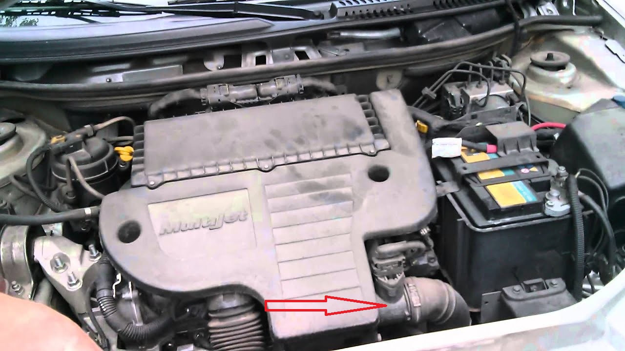

The maff sensor is separate to the airbox engine cover
The sensor is arrowed in the picture and is removable from the air box with three 10mm head bolts

The sensor is separate to the air box and only held on by Three 10mm bolts
A simple adaptor can be made to fix the the sensor flange so that a cone filter could then be fitted via flexible pipe the front left of the engine bay
