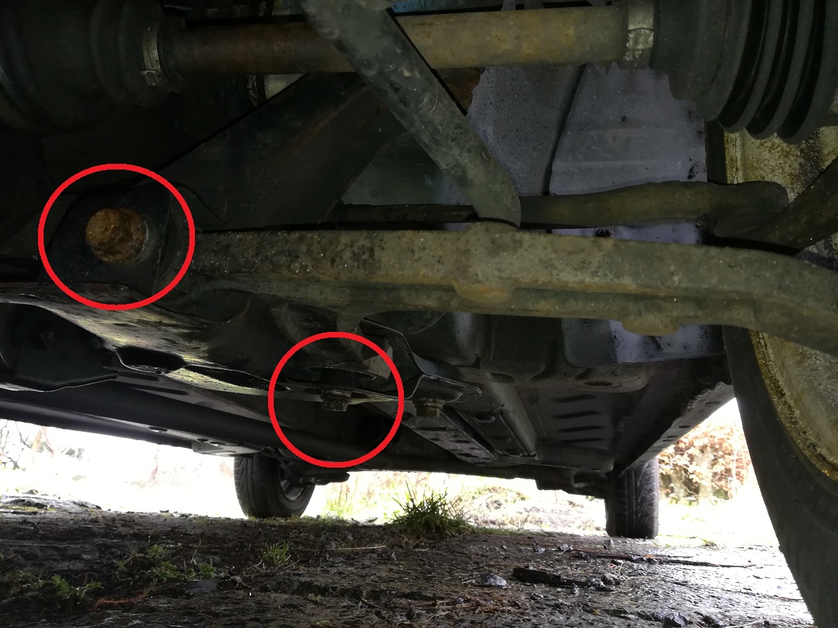

Just recently I have noticed a knocking sound when I turn the steering wheel at low speeds
Start by getting an 18mm spanner on these two bolts on each side and check they're tight. No need to jack the car up.
If that doesn't help, jack one front wheel up at a time, push and pull wheel with hands at 12 o'clock & 6 o'clock, feel and look for any movement, repeat with hands at 3 o'clock & 9 o'clock. Make sure car is safely supported before getting under it.
The sound is either suspension, steering, or driveshaft.

Right okay, regarding the clunking noise today I used the car multiple times and it has completely went away. To be honest it only started doing this clunking noise after I was trying to get the o2 sensor off. At one point would spray penetrating oil (which I now know doesn’t work because it’s seized unless you use a proper blow torch). I would use to hands on the spanner and can see the exhaust moving and even had kicked the spanner at one point and it broke the spanner. I was thinking that this is what caused the problem of the clunking noise.
Why do you want to change the o2 sensor? Has it failed? There should be a fault code for that.
