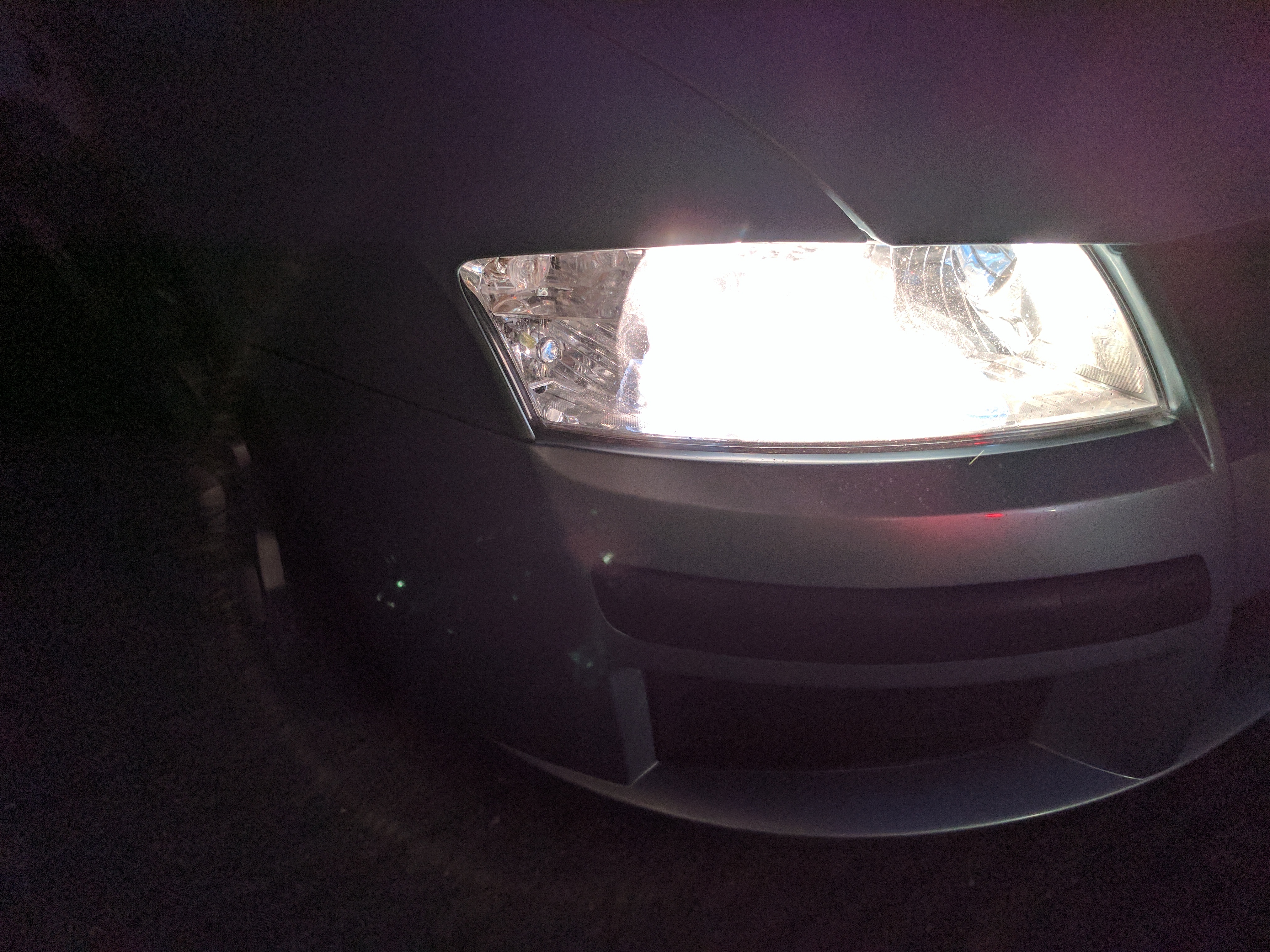

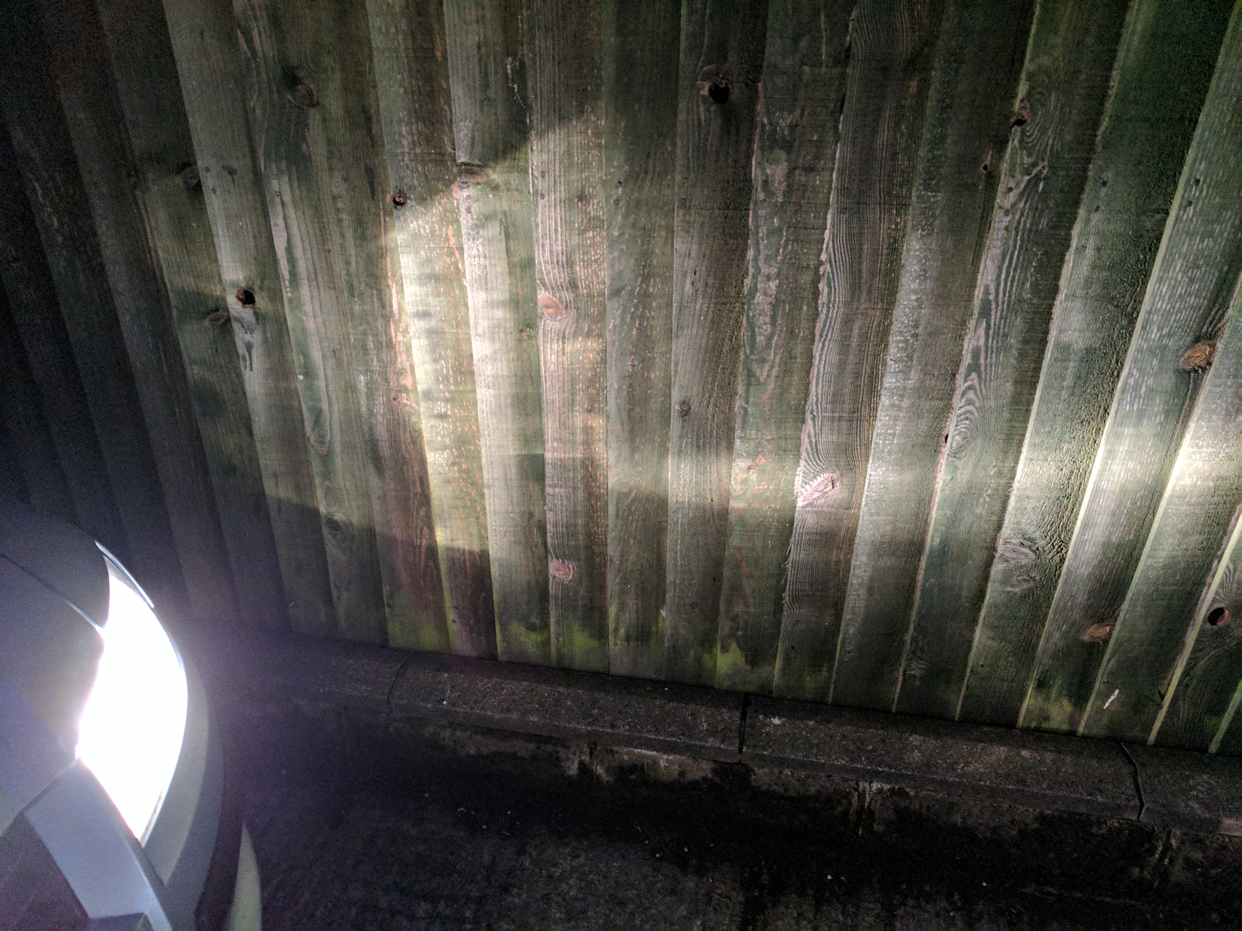

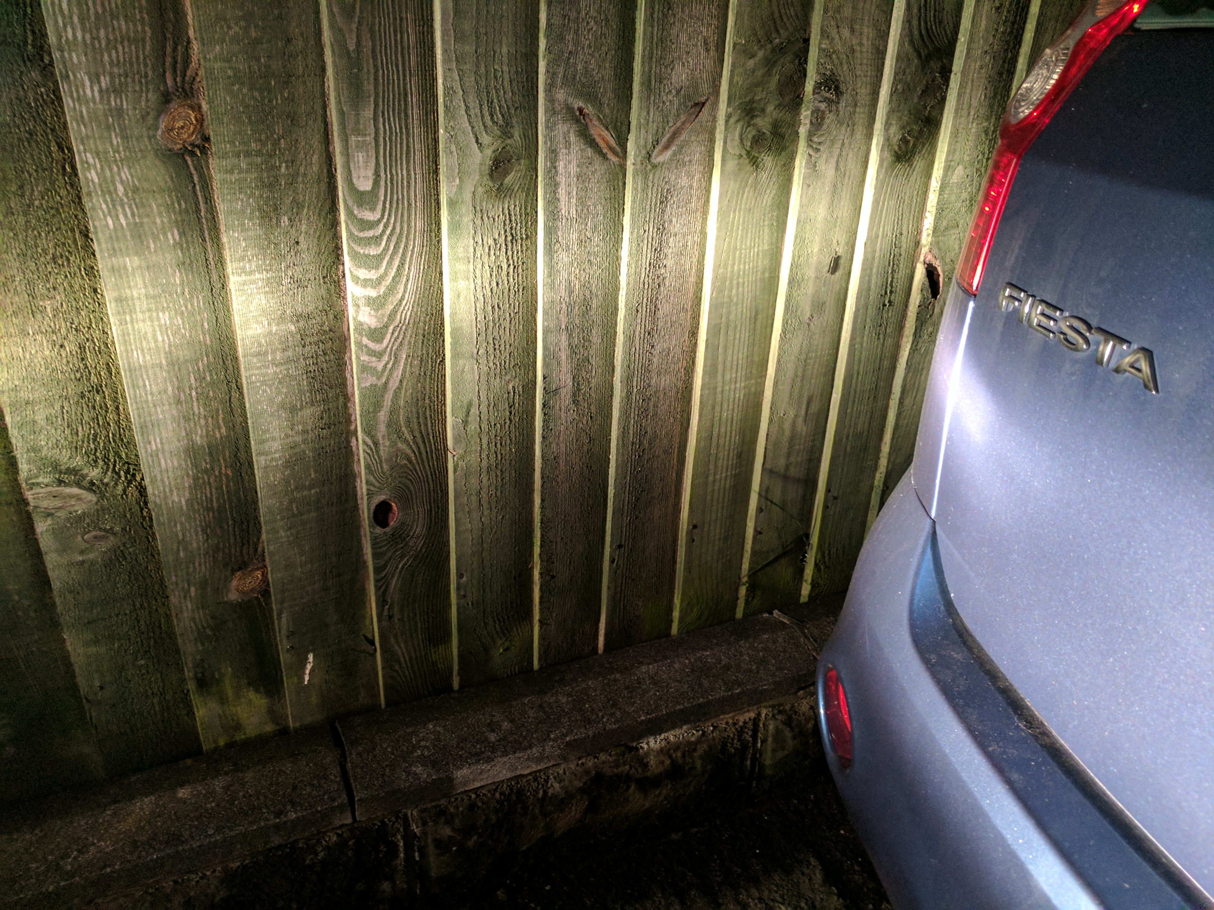

These are what I fitted to mine the other day. They look great in the car, and are great value.
