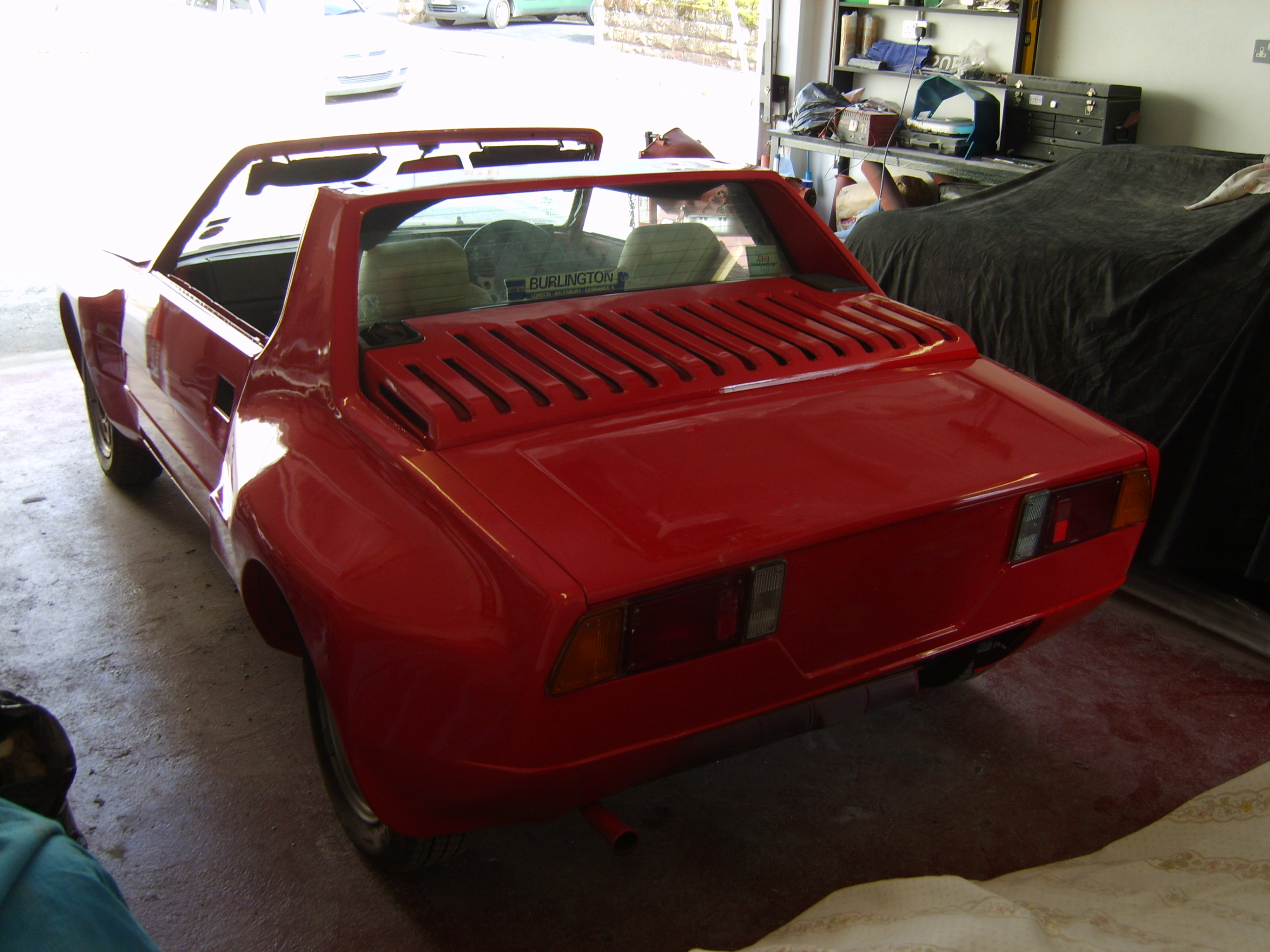

Since last pics were taken :
Fiber glass nose cone fitted
Nose cone de-badge and fiberglassed/fillered
Back wings where the Bertone badge goes has been fiberglassed/filled
Bottom of back wings fiberglassed and fillered.

But The Car Has Been Sprayed Now (y) Rosso Red.
Since Last Post I Have Brought And Fitting/Fitted:
A CSC System
Brought New Disks
Brought New Pads
New Halogen Lights
And I Have Got Some Wheels For It Aswell Now Compomotive MS Wheels Now :D 13" x 6 And 13" x 8 Just Got To Find Where I Can Buy Some 235/245 Tyres For Them.

Here are the picturecs i said i would give. Hope you like it.
Cheers :D

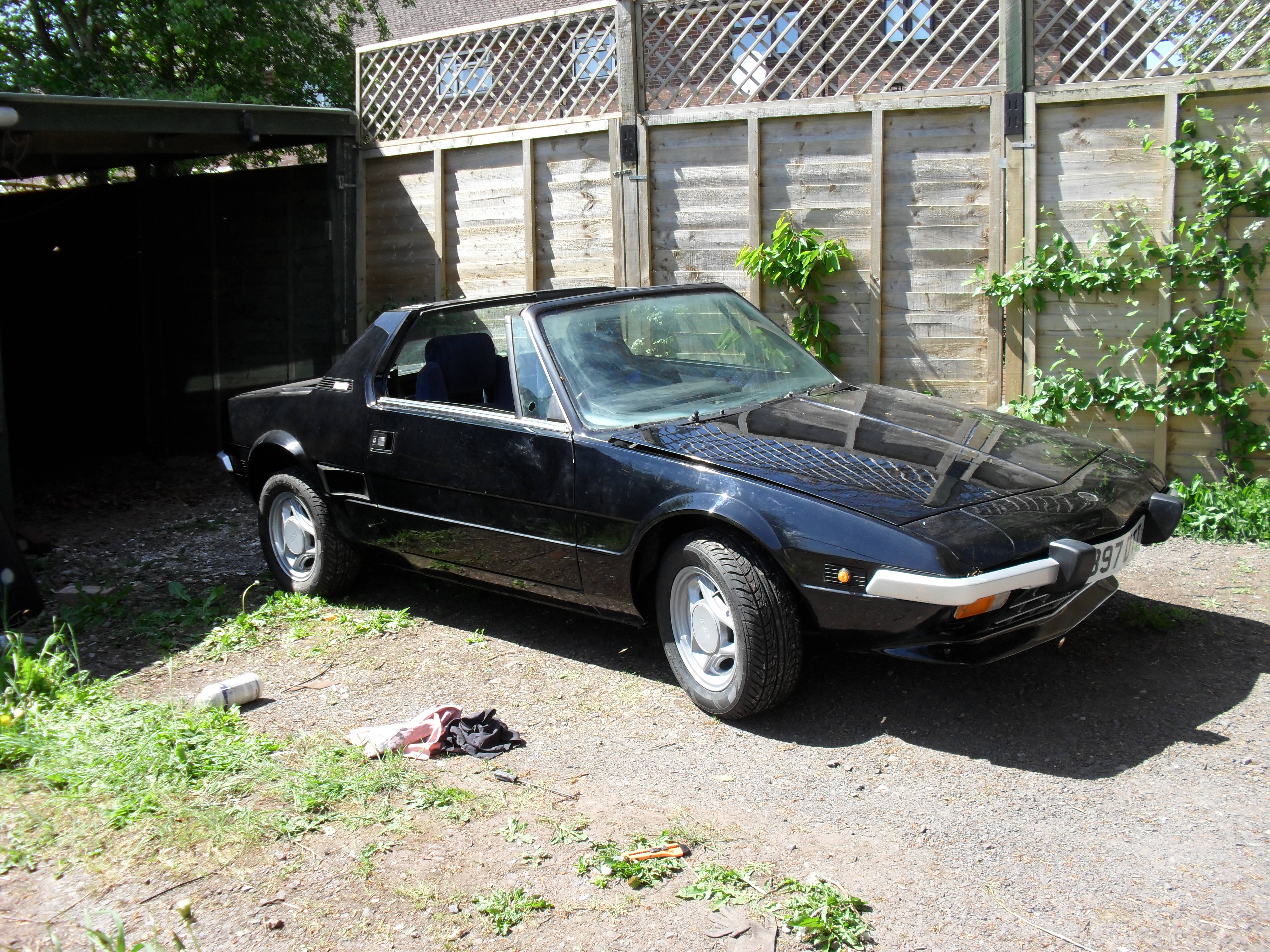

Looking good Brae91
Like the colour, wish i did my in something similar rather than black but gone to far with it now
Just an update, almost ready for MOT just fitted new screen thanks neil for that,
