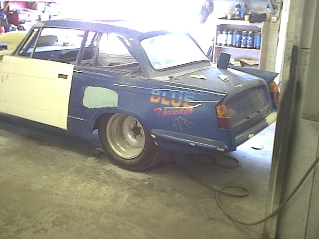

The Yellow Car Is A 1962 GSM Flamingo....I Don't Own It My Dad's Mate Owns It Who We Are Sharing The Garage With....There Is Also A Herald What Has A 7.2 Litre Big Block Chevy Enigne In It:D What Is Being Used By My Dad For Drag Racing:slayer: He Race's It At Santa Pod Raceway And Avon Park. Here's Some Picture's Just In Case Your Interested.....

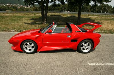

i do have a big problem tho....wat i'm sure jimbro or others can help me with......my back wheels are not in the center of the arch....if i go over a big bump the back of the wheel could hit it......is there anyway of moving back the wheels? i have read about this before on another website but can't remember wat it is called...so you lot are the next best thing lol

The problem is the car the bodykit was taken from had the wheelbase extended backward by a couple on inches. This was achieved with custom-made rear suspension arms.
You have three options with the bodykit, move the arches, move the swingarms or accept that the arches are a touch further back than they should be (visually).
Moving the arches is a hideous task and very hard to get right, I certainly do not recommend it.
Changing the swingarms is a lot more feasible but is a specialist fabrication job and won't come cheap - on the upside you also have a chance to work around the rear ball joint problem that most X1/9 owners have.
Just leaving it as is may sound like a cop out but that is what 99% of people do in this situation. It looks a lot less odd once you have got wider wheels on the rear and they fill the arches out.
From a panel beaters point of view cutting the wheel arch does not seem much of a problem but if you are not confident with doing that you can make a right mess of things.Good luck with the rest of the car.
The problem is that the panels are GRP rather than metal, a lot of the strength in the panel would be lost from cutting the arch out and moving it, not to mention disrupting the flow of the lines.

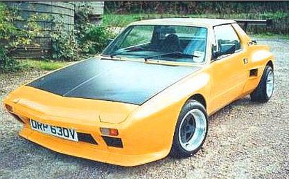

I just left mine as-is (circa 2003) - pending the creation of custom adjustable swing arms for the rear:
and what it (still) looks like now:

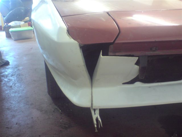

My Front Spoiler/Valance...What ever people want to call it.....doesn't fit...it has like a 2 inch gap at the top where it connects to the front side archs.....is it meant to be like this.....am i meant to fiberglass the gaps?
Any Advice?
i'll put up some pictures if you don't know what i'm on about......

it sounds very odd to me but this is exactly the sort of thing that led me to have my own custom moulds made.
I will wait until I see the pictures before making any suggestions.

Jimbro I Have The Pics For You.
