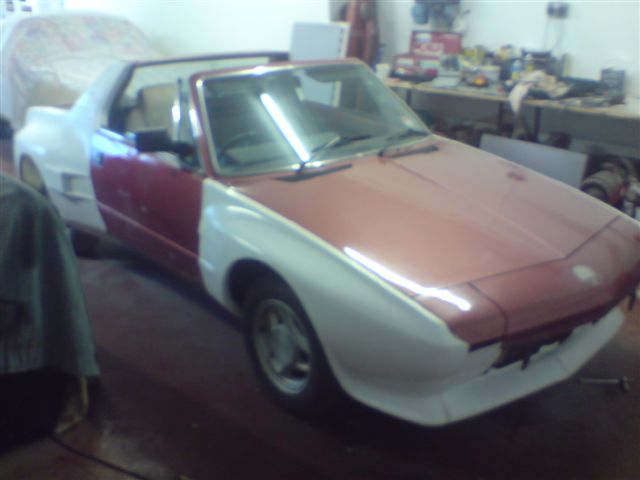

General This is my car so far after some mod's
Hey

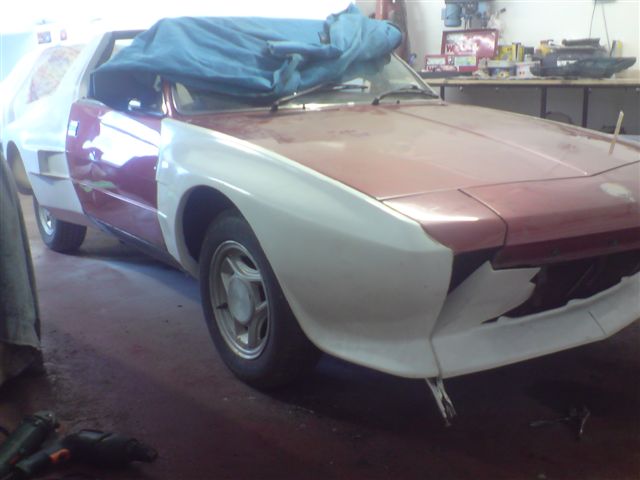

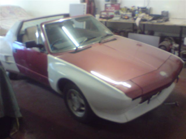

I Got Around The Problem Above ^^^^ By Cutting The Bottom Of Bent Bit And Bolting It Straight, So Now I Will Just FiberGlass Over It To Join It Back Together :D

Here's Some Pics!:D

Looks like you've solved it anyway but the original problem appears to be that the front wings have been pulled out of their original lines which is in turn squeezing the lower valance and twisting the ends.
Typically you would leave the bottom of the wings loose and bond the valance into place and then see about fixing it to something underneath instead of the other way around. Given your approach this wouldn't have worked so I believe you've done the right thing.
