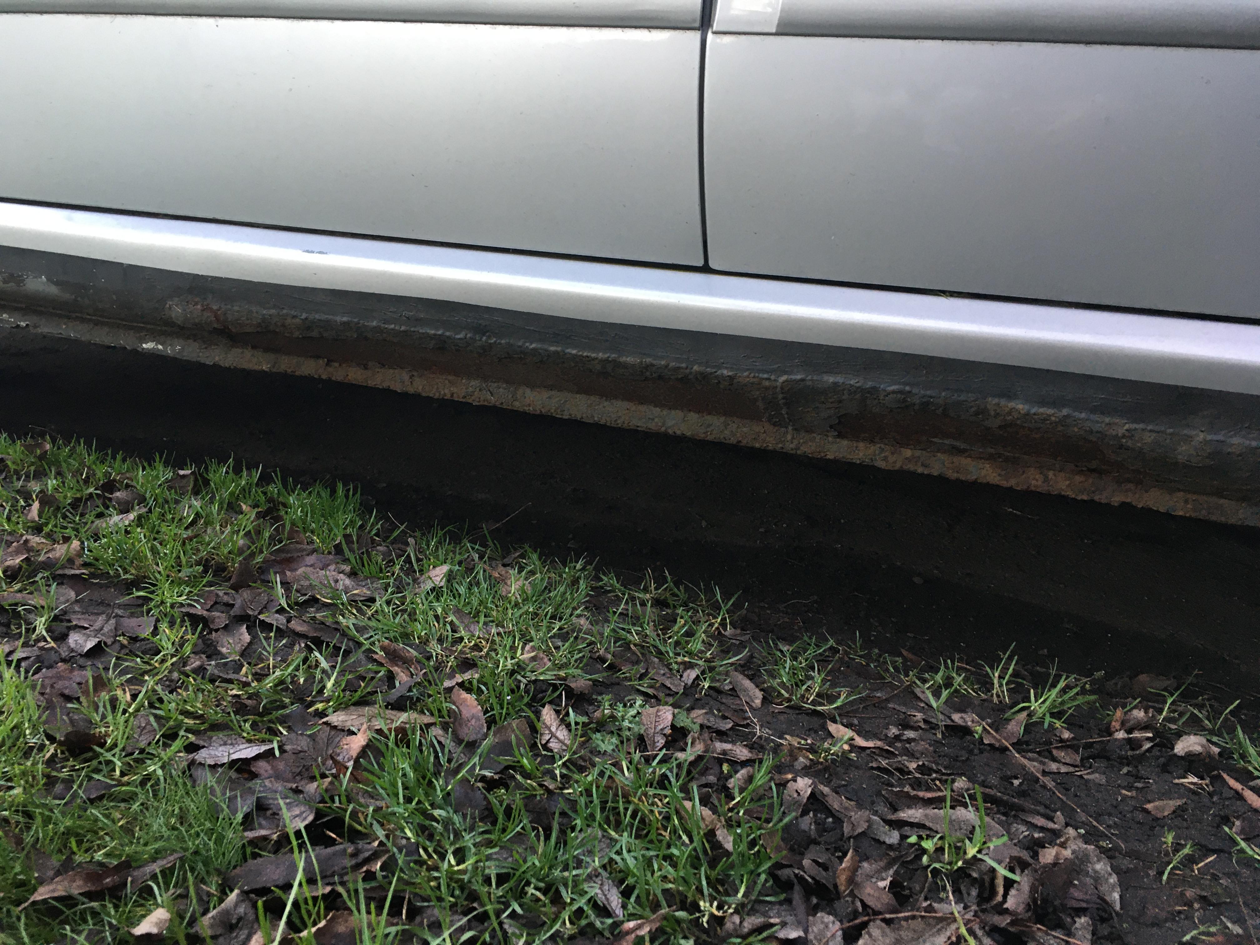

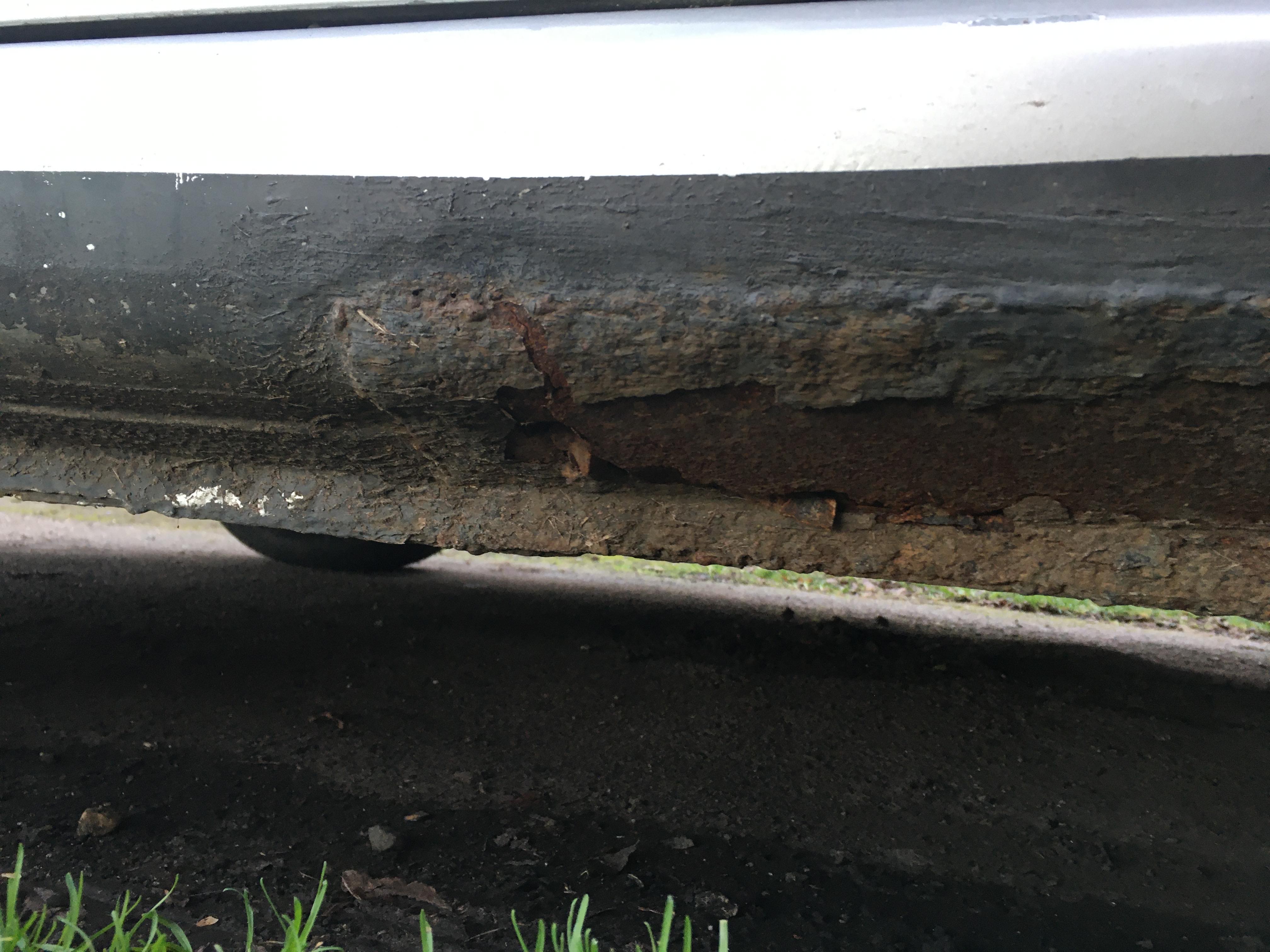

This would fail an MOT, wouldn't it?
Hmm looks like a long standing issue as well given that's clearly hammerite or similar brushed on, once you start poking at that you're probably going to go straight through..and end up having to grind a lot of sill out to get back to clean metal.
Edit looking at other pictures appears to have been patched multiple times probably new sill time if the rest of the car is worth it.
It's a POS 307SW, definitely not worth saving, pretty sure it only cost the father in law a few hundred £ so it was never intended to be a long term car, I think he was just hoping it'd get thru one more test but I doubt it
Might get lucky with another patch, but given the other holes water will have sat in the sill and it's probably going to have the rigidity of wet lettuce.
