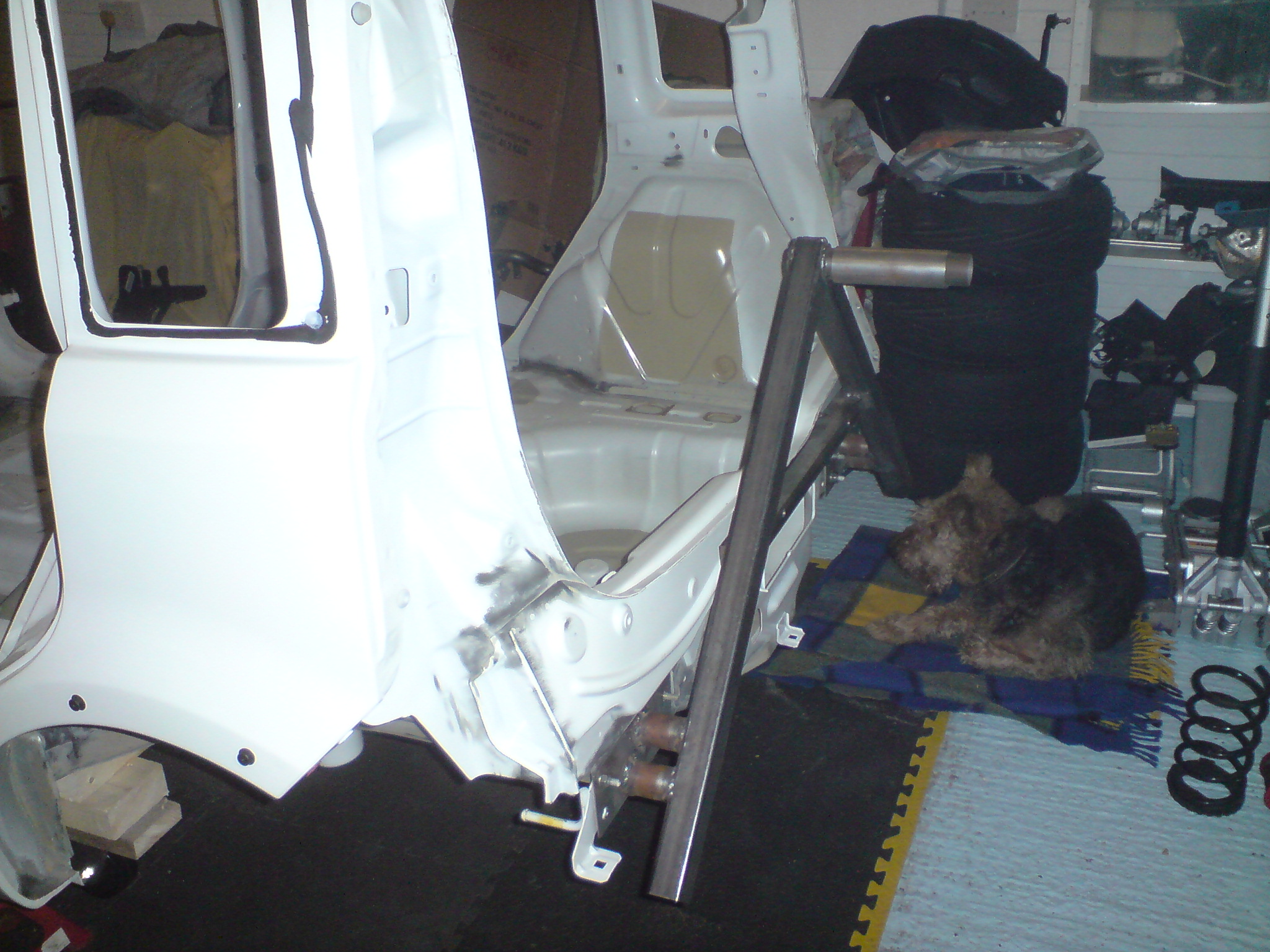

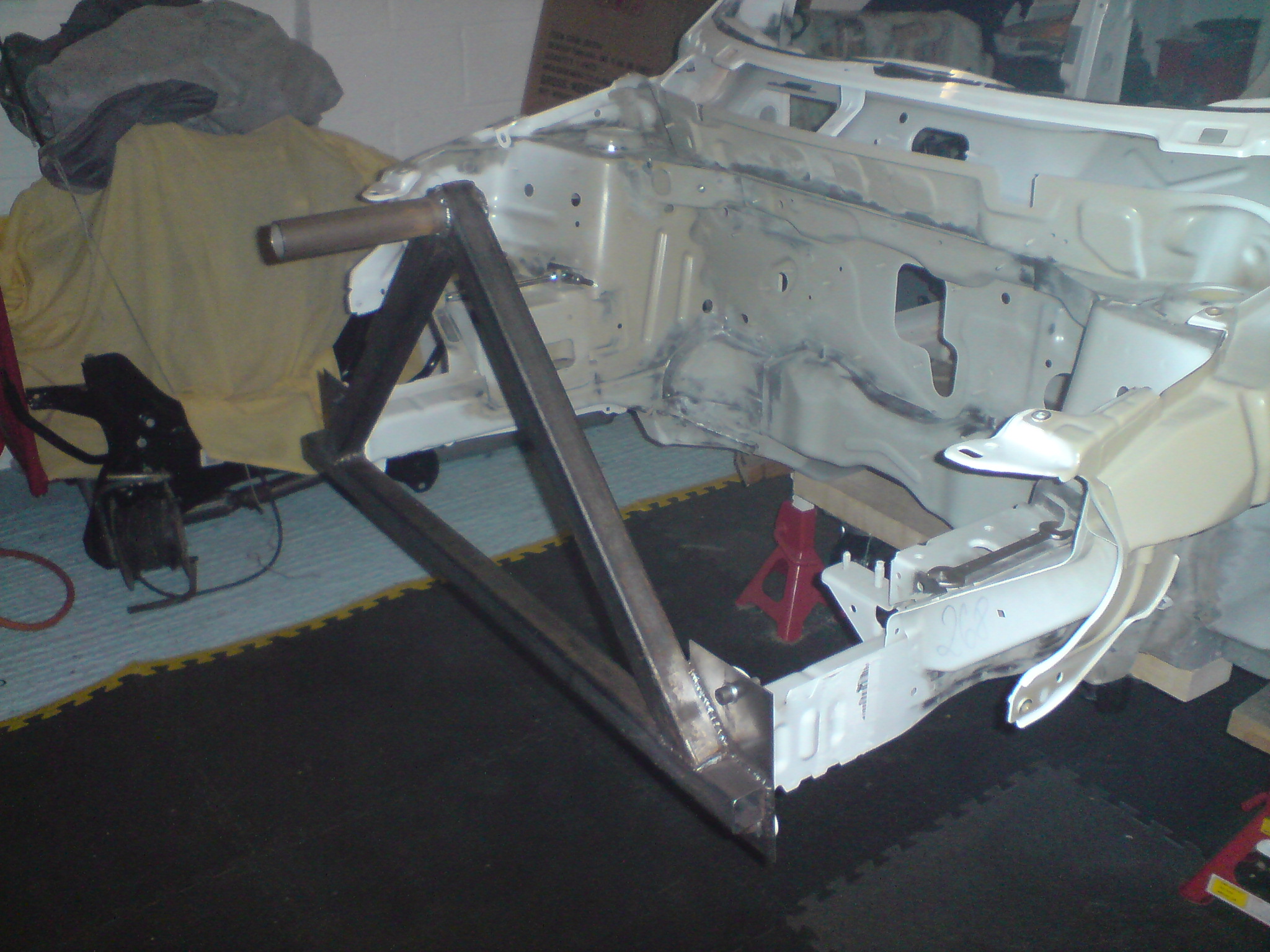

I've been busy today out in the Garage making the frame to sit the shell in a "Spit roast" fashion. This way I can swivel the car around and get it wherever it's most comfortable to weld the shell/cage.
I've nearly finished the rear, which is twice as complex as the front, so hopefully I'll get the front done tomorrow, and get some pics up for you all to see. The tubing for the actual spit roast legs will arrive on Weds/Thurs, so next weekend the shell should be ready for the off!!!:D:D..or is that more Underseal and seam sealer removal:cry::cry:....
As promised, some pics of the frames that'll hold the body in the air, in any position for the seam welding and underseal removal.
Basically, these frames will sit in two engine stand like frames that will allow the body to swivel.

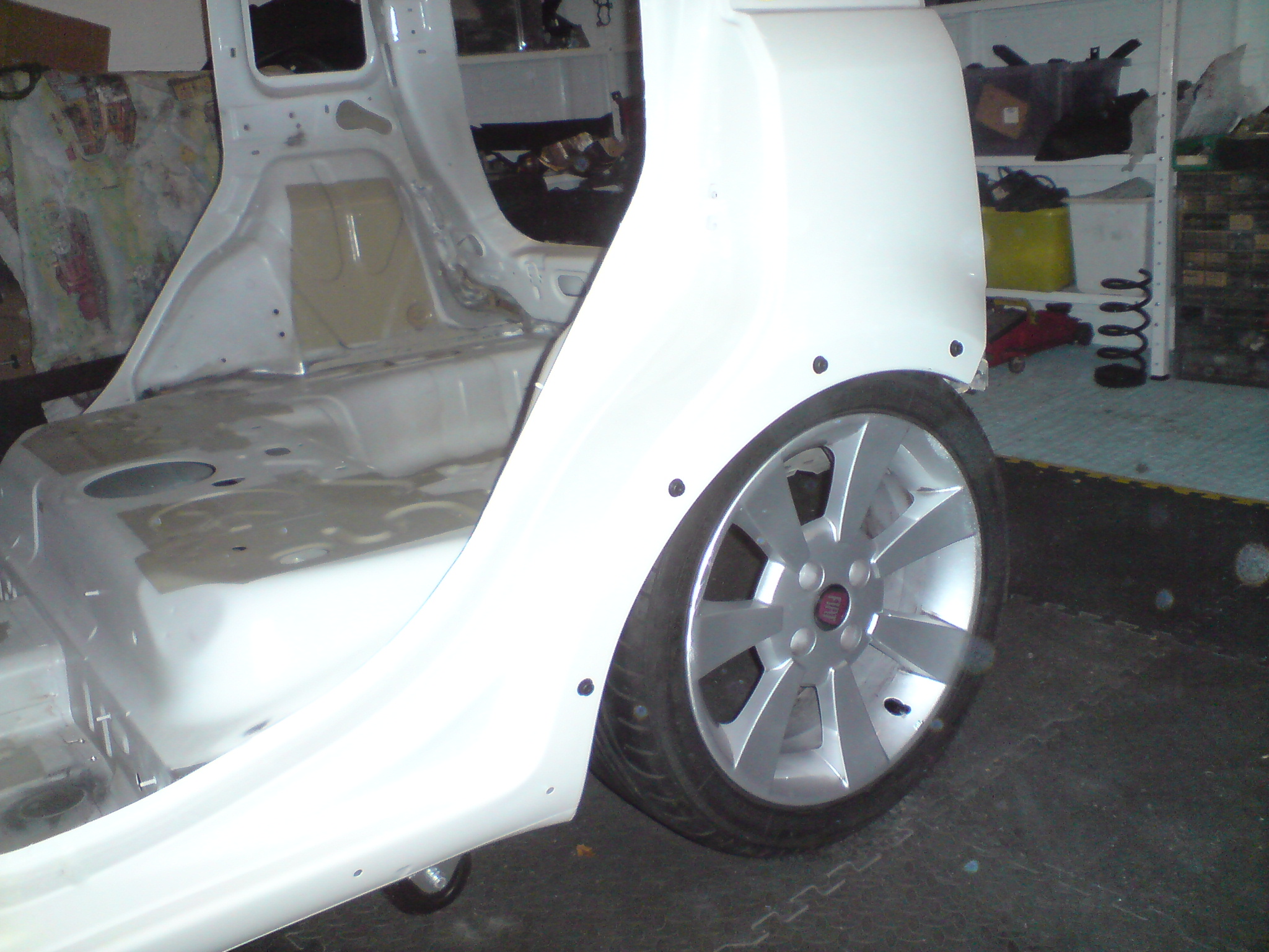

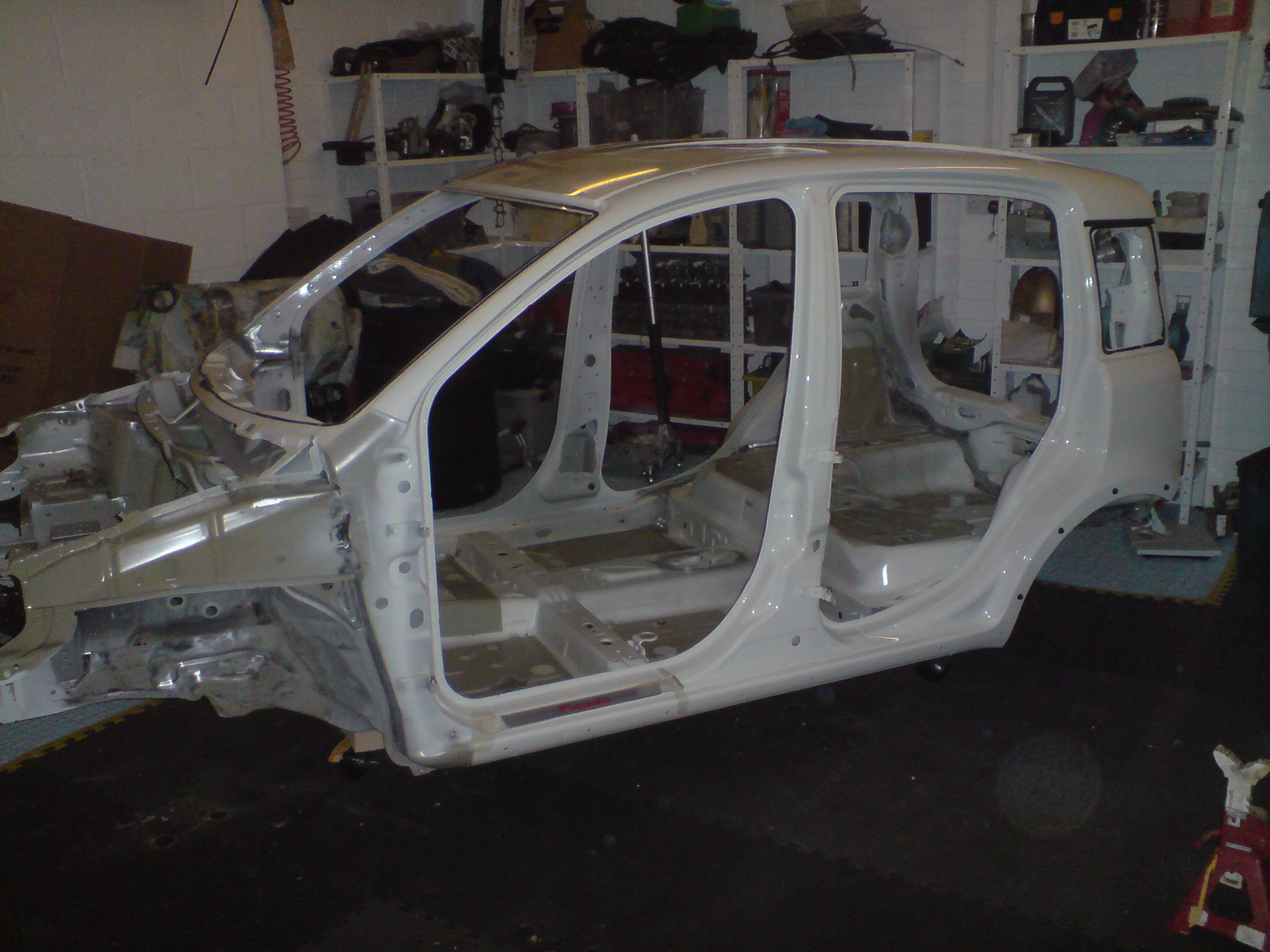

I've also posted a couple of pics of the car on castors, so it can be rolled in and out of the garage. There's also one of a wheel put in the rear arch. Possibly the lowest Panda in the country??
