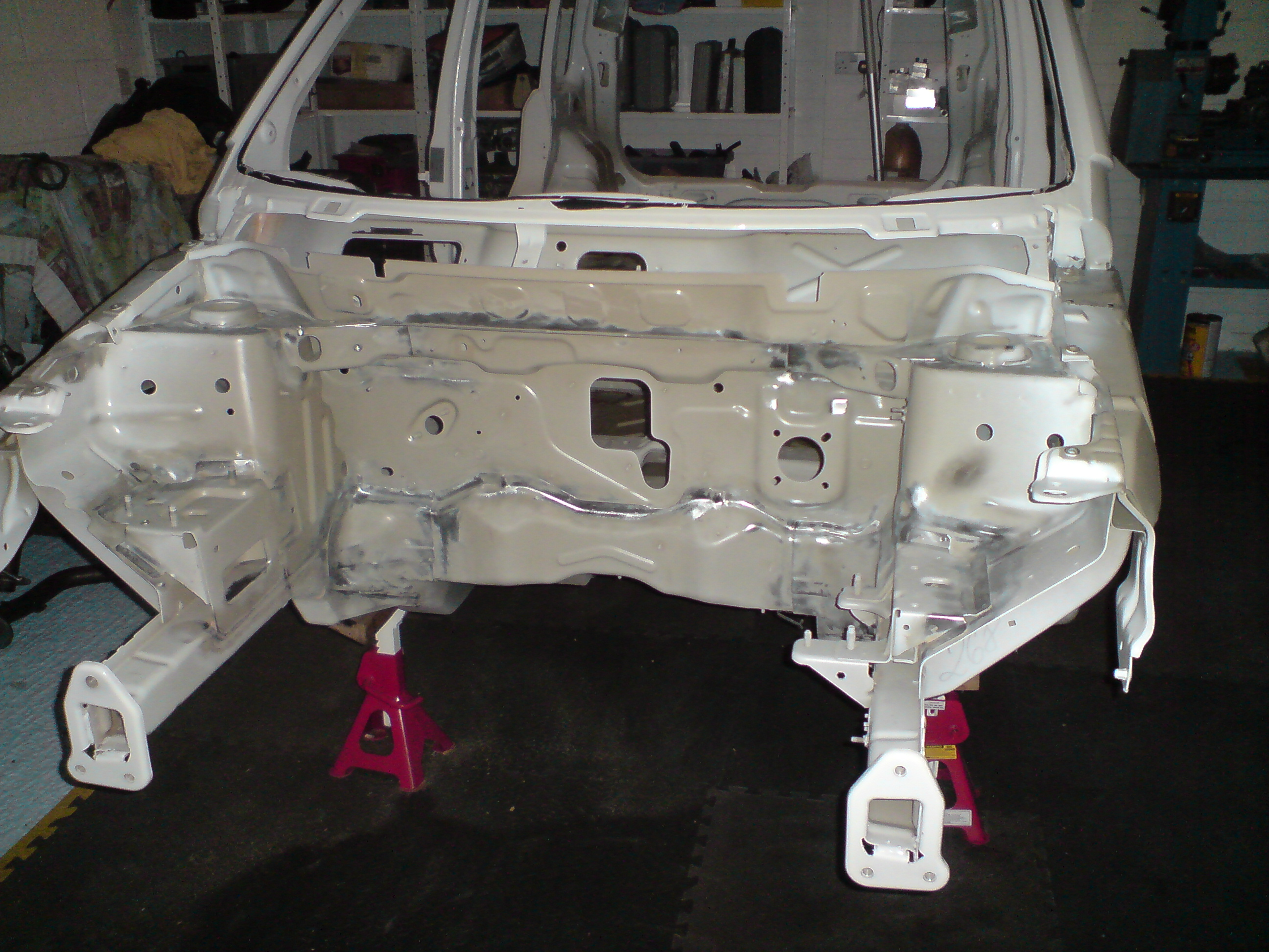

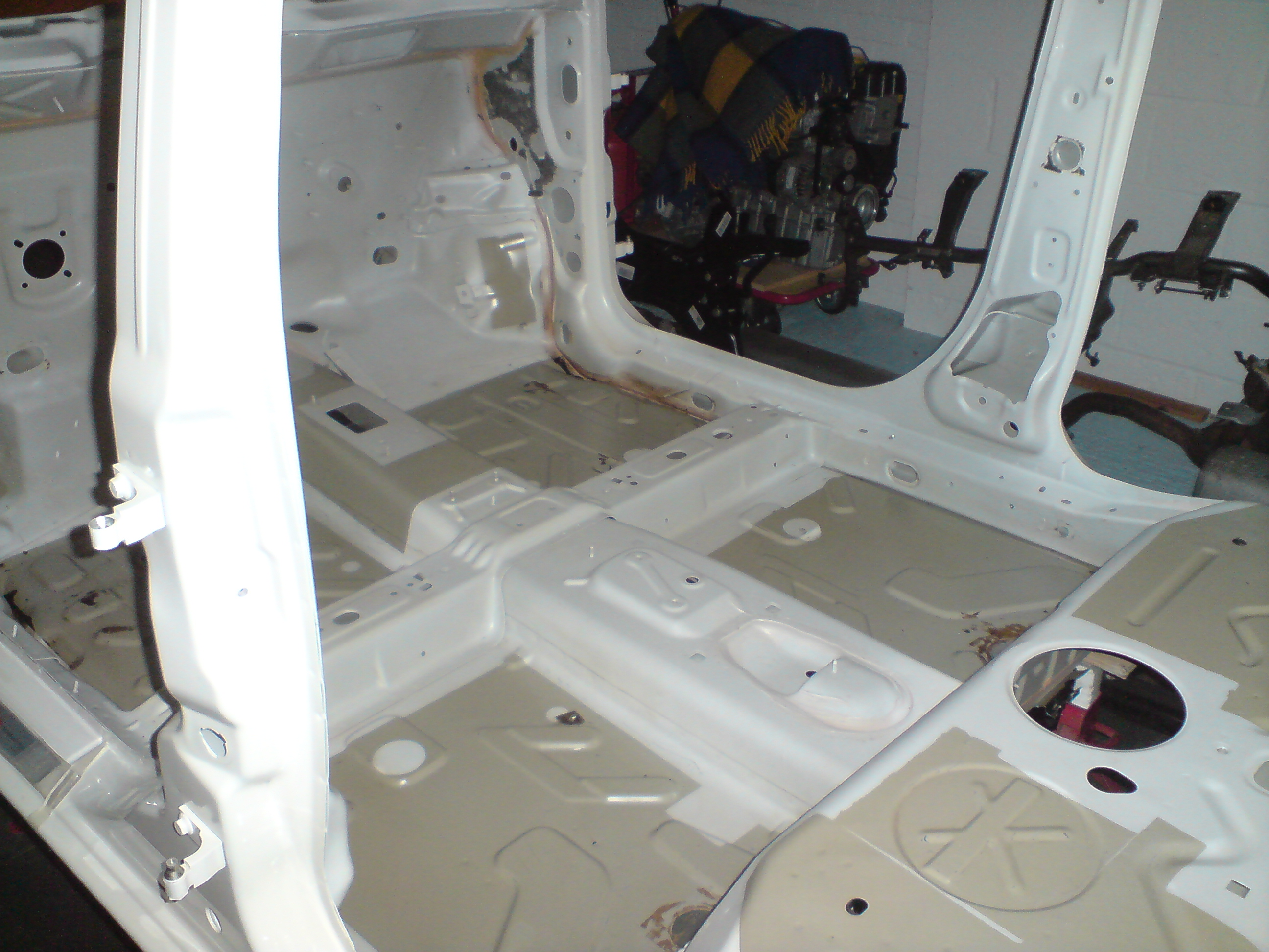

The seam sealer is a bitch to get off. But has to come off for seam welding.
Thanks to Brooky for the advice on removing the sound deadening pads. I've always used a heat gun and scraper, then finished off with Brake Cleaner. Brooky suggested using Petrol :worship::worship:. Faster easier and cheaper. Thanks Mate.

Just in case anyone is wondering what their panda looks like with no Dash, here you go. The Dash supporting beam that carries the gearshift and Heater/Aircon, looks mighty heavy!!!!
Brilliant photos - thanks!
Around this time last year there was one in the workshop of Palmers in Watford stripped back nearly as far as this, as a small plastic bit had broken off the climate control system, and they were replacing the whole heater box! That seems to be the unit everything else is built around. It was being done as a warranty job -- just as well as I guess that was several very expensive hours of labour.

It's not the Yellow that Fiat dont charge for, its a primer, which I believe is etch based. I must say, the build quality of the bodyshell is nothing short of Fantastic!!! The Gavanising on the floor and Bulkhead is of a very high standard. Shame really, cos I'm gonna struggle with my seam welding....
