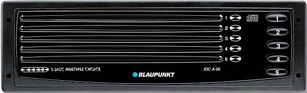

Just a wuick question - which button releases the CD's from the changer at the bottom of the centre console? Got one stuck in there and no buttons work to release it?
New to this Fiat Punto, not totally sure about how it works yet lol
I don't know which CD Changer you have. If it's the IDC-A09 one in the picture below, press and hold the appropriate numbered button for about 3 seconds to eject a CD normally.
If the CD is actually jammed in the mechanism, you will need to take the changer out and open it to release the CD.

If all 5 CDC lights are flashing, it generaly indicates that a CD is jammed in the mechanism or the mechanism is broken or misaligned.
