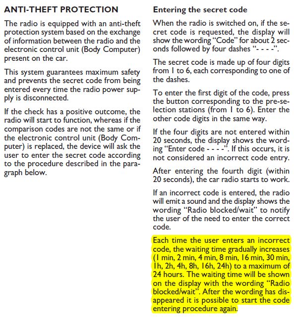

Hi Ive had the ignition on for over an hour on numerous occasions and it still shows radio block/wait. At no point has it given me the option to enter the code? Im lossing all faith in it now?? Any other ideas? I would really appreciate it
Thanks Princess xx
The waiting times for your Fiat 500 radio are the same as I posted above in post #1373, so depending on how many times you, or someone has tried a wrong code, it could be up to 24 hours.
This is from the Fiat 500 radio manual.
