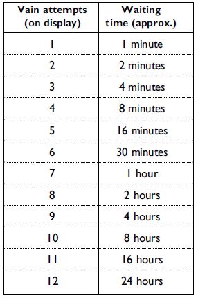

My radio still writes RADIO BLOCKED / WAIT and cant put the code.
Is there any reset button or do i need anything else to do ? I tried unplug for 2 hours but still the same.
The radio says "BLOCKED/WAIT" because someone has tried a wrong code too many times. You need to leave the radio and ignition switched on continuously until the "BLOCKED/WAIT" message clears, then enter the correct code.
Depending on how many times a wrong code has been tried, the waiting time could be up to 24 hours.

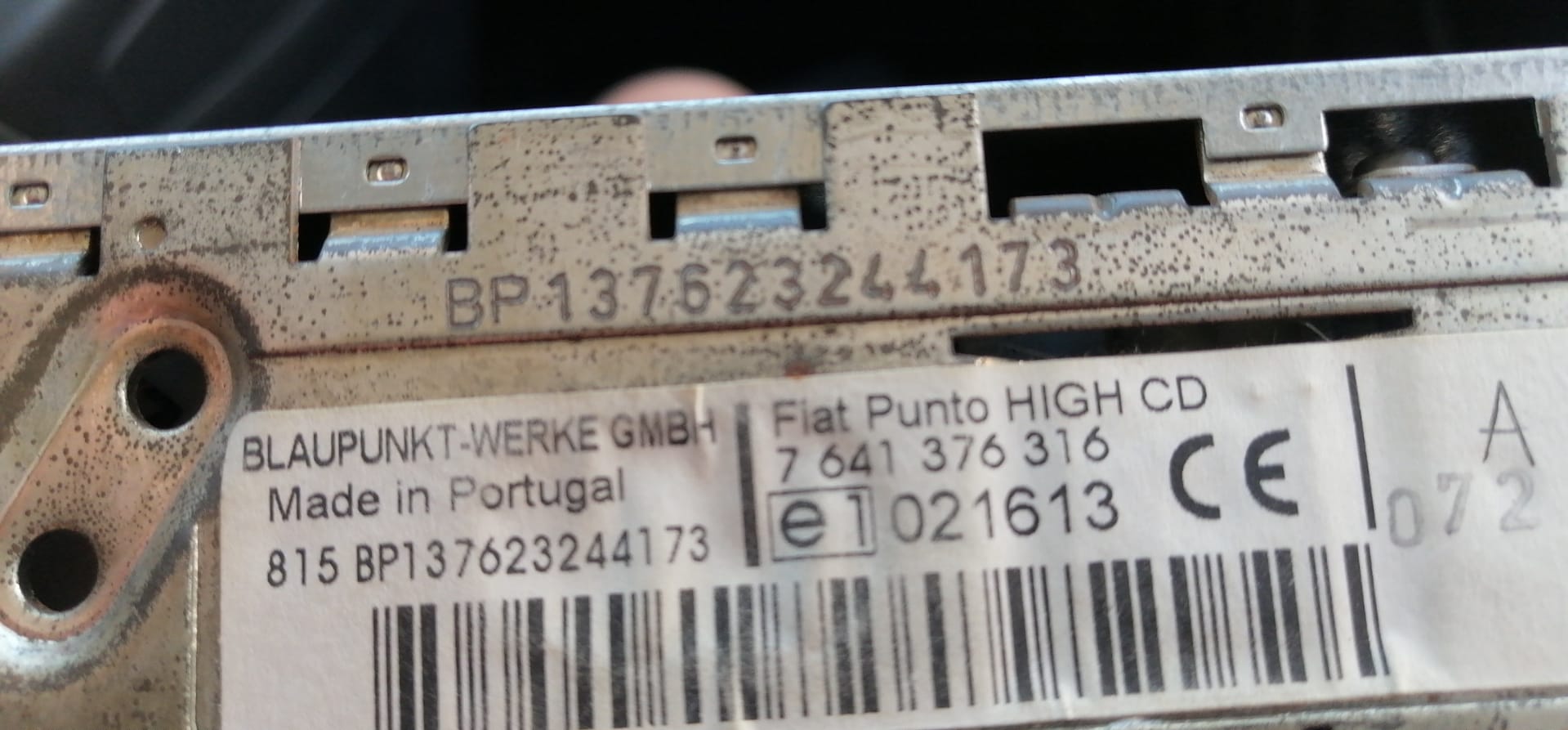

Hi my friend.
Can I have the code for this radio from a Fiat Punto - SN in photo attached?
Cheers!
