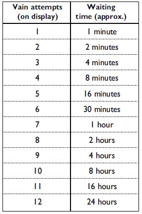

The radio says "WAIT" because someone has tried a wrong code too many times. You need to leave the radio and ignition switched on continuously until the "WAIT" message clears, then enter the correct code.
Depending on how many times a wrong code has been tried, the waiting time could be up to 24 hours.
