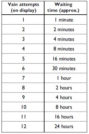

If the display is showing Blocked / Wait, it's because someone has tried the wrong code too many times. You need to leave the radio and ignition switched on continuously until the message clears. Depending on how many wrong codes have been tried, the waiting time could be up to 24 hours.

If you've only entered the code once, then according to the table above, you should only have to wait 1 minute before the blocked message clears.
