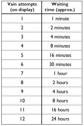

The display shows blocked/wait because too many wrong codes have been tried. To clear it, you need to leave the radio and ignition switched on continuously until the message clears, then enter the correct code. Depending on how many wrong codes have been tried, the waiting time could be up to 24 hours.
