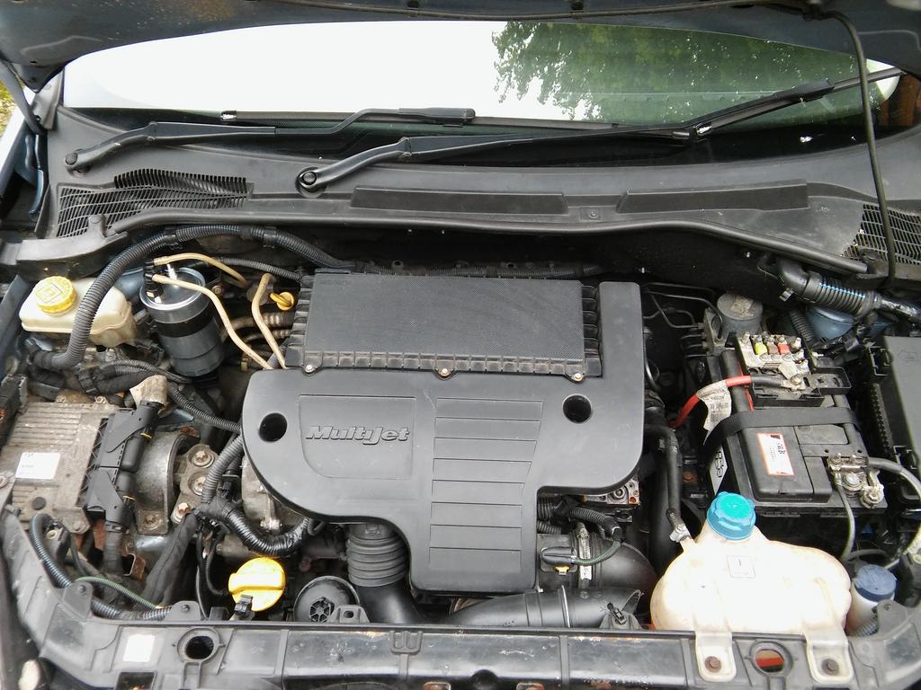

a new airbox/engine cover was needed as the original was broken, the front bumper needed a side grille cover, I found that the seal across the bulkhead was missing so I replaced that, a clip on the sun visor too.
before the car went into full time use, I gave it a service of new oil and filter, diesel filter, air filter, pollen filter, by the time you read this its already had its second change of oil and filter under my ownership.

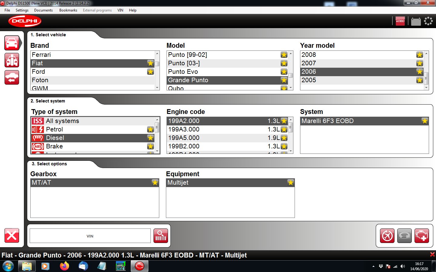

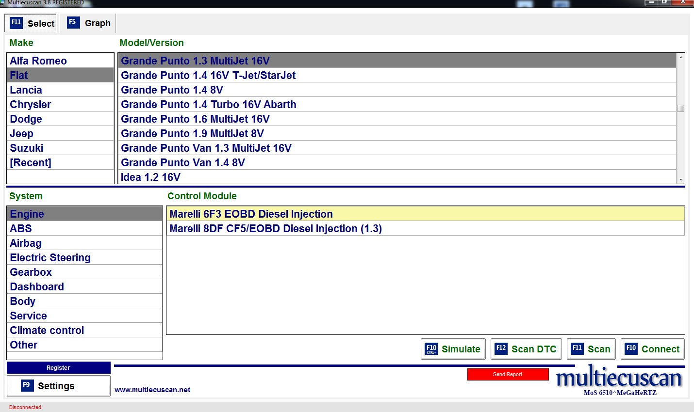

I also got an
MES set up on my laptop with the cables, I have a small Asus T100 Transformer Book now and its ideal for
MES. I was also given a Delphi clone [sold as Multidiag] and cables which I can run on any car, its much like
MES in many ways. See screenshots of both:

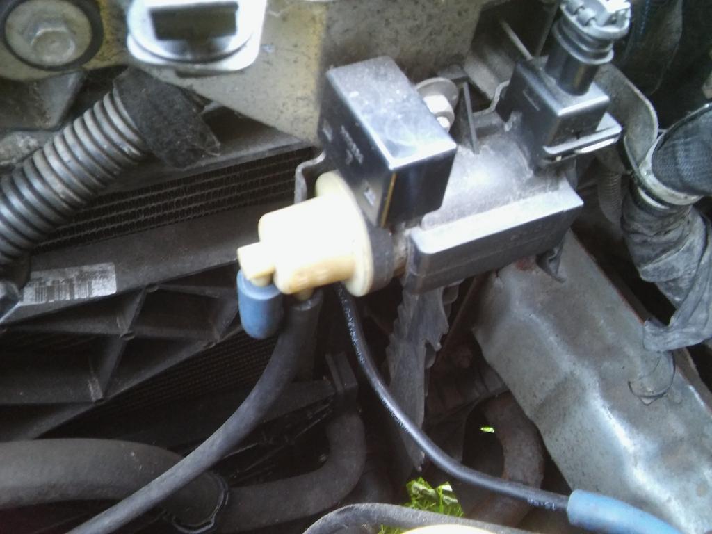

so, the car didnt pull well at first, it seemed ok on the test drive [like they all do!] but a few miles later on during the trip home it wasnt right and there was a bit of black smoke from the exhaust, as the turbo on the 90 is electronically and vacuum controlled [not self controlled like the 75bhp version] I thought it was the vac pipes, they were all replaced, but the fault remained - although perhaps not as bad, it turned out to be the Pressure Converter which is a valve in the vac system that controls the turbo variable geometry, there was no fault showing for it, but a bench test with a vac pump showed it to be not working. A new pierburg valve sorted it, in fact I have a brand new spare as the seller sent it twice by mistake all the way from germany! Prior to my test drive the car had been out of use for a few months, this would not have helped.

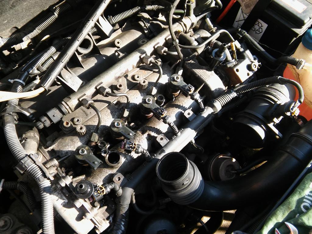

at the tail end of summer 2019 I was noticing diesel fumes inside the car, it was no2 injector seal leaking, I had to do the job twice as first time I didnt have a seat cutter, and also the seal was stuck down the hole, so with new tools bought this job was done, all 4 seals have been replaced now and more knowledge gained, I also have quite a few sets of various thickness of spare seals too. At around the same time I noticed it wasnt starting too well, its lack of compression didnt help [before the seal change] but I thought it could be glow plugs, I bought a set of new ones but didnt need them once the seals were done, and pressing the clutch in on cold start [it says to do that in the owner book!] it was bang on, so I have a set of glows spare. Thinking back to when I got the car I could smell slight fumes in it, I put that down to it not having a DPF, so the problem could have been there a while but just got worse with the car in use.

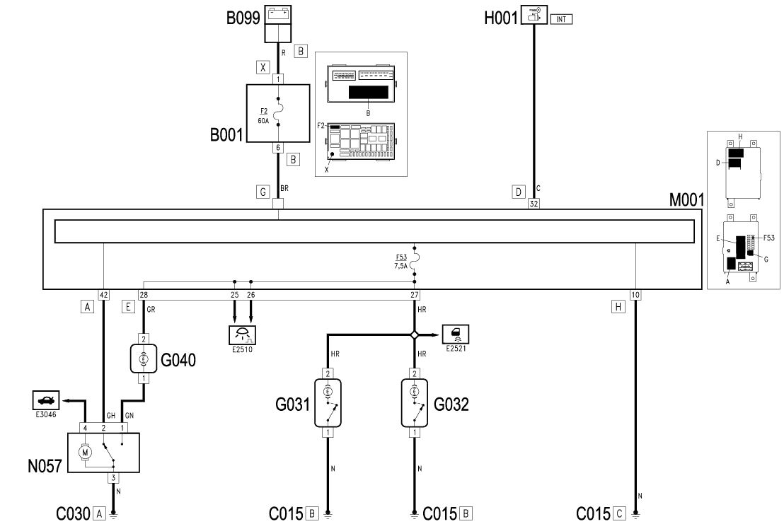

The driver door lock stopped working from the inside, this happened twice but the first time it failed I was able to make a repair, the second time I just went to a local fiat spares place and bought a used mechanism, with a view to repairing the original but I think something else failed within the original so it got binned! at the same time when I had the door card off I noticed the door speaker was rotted through, so I just replaced the one with a good original from the same place I bought the lock from- I am still wanting to put new speakers in the front, just direct replacement woofers but dont know what to buy.

the car was run all winter with no problems other than a noisy front suspension top mount, in late feb? could have been march actually, and while looking to see why the boot light wasnt working, disturbance of the lock mechanism also meant the boot open warning light stayed on, a bargain replacement lock sorted both issues, the old lock was knackered internally on the PCB and pins.
