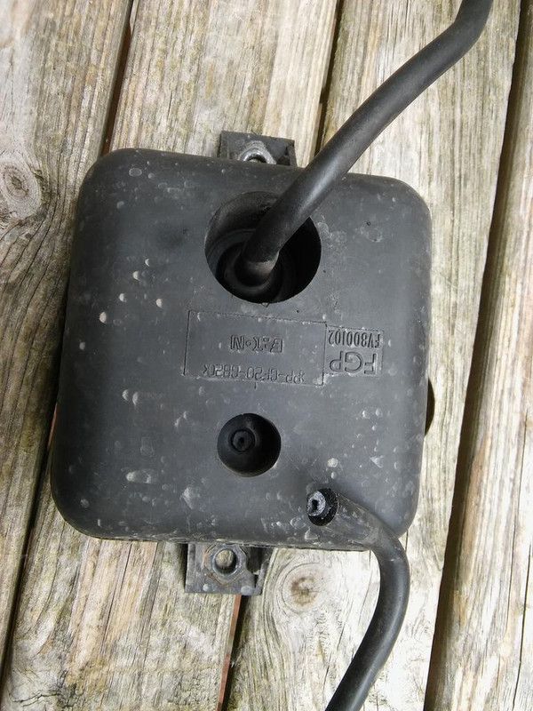

So I thought I would replace the last two vac tubes, that go into and out of the vac accumulator.
and this happened
The remaining pipe comes from the vac pump, if I suck this [stop it!!] I can suck through it, but I cant blow through it, so in there is a check valve.
Other than that I cant see it doing much other than holding a tiny bit of vacuum when the engine is off.
I have put a tube in bypassing it for now, everything seems ok.
I will buy a small one way valve to put into the tube, just in case it really needs it.
As this is now scrap, I might cut it open to see whats in it [nothing, likely]
There is nothing in there, the purpose of this réservoir is to stabilize the vacuum pulses and insulate the turbo vanes actuator from the brake servo... So it DOES something else than storing a little vacuum !!
The port can be repared with UV hardening resin.
BRs, Bernie

and its running very well indeed, although I bought a replacement vac canister I have not fitted it, I have put a one way valve in the vac tube which acts in the same direction as the one built into the tank does, its made a remarkable difference to it boosting up a bit sooner
if there are any detrimental effects, it will get fitted.

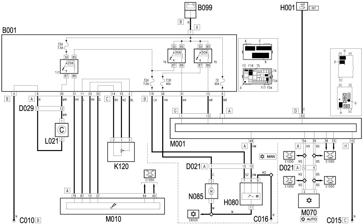

Have you checked the compressor clutch circuit before doing a gas refill ?? I would !
One bad relay or a blown fuse may result in a non working AC, here is the drawing ...
BRs, Bernie
