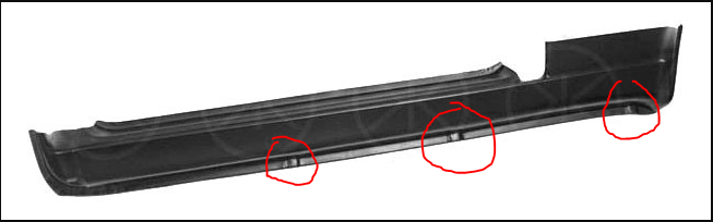

them 3 points along the sill, you should be able to poke a small wire up through them between where this panel meets the inner sill panel

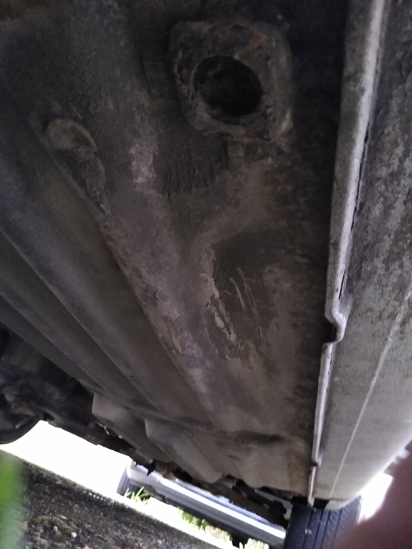

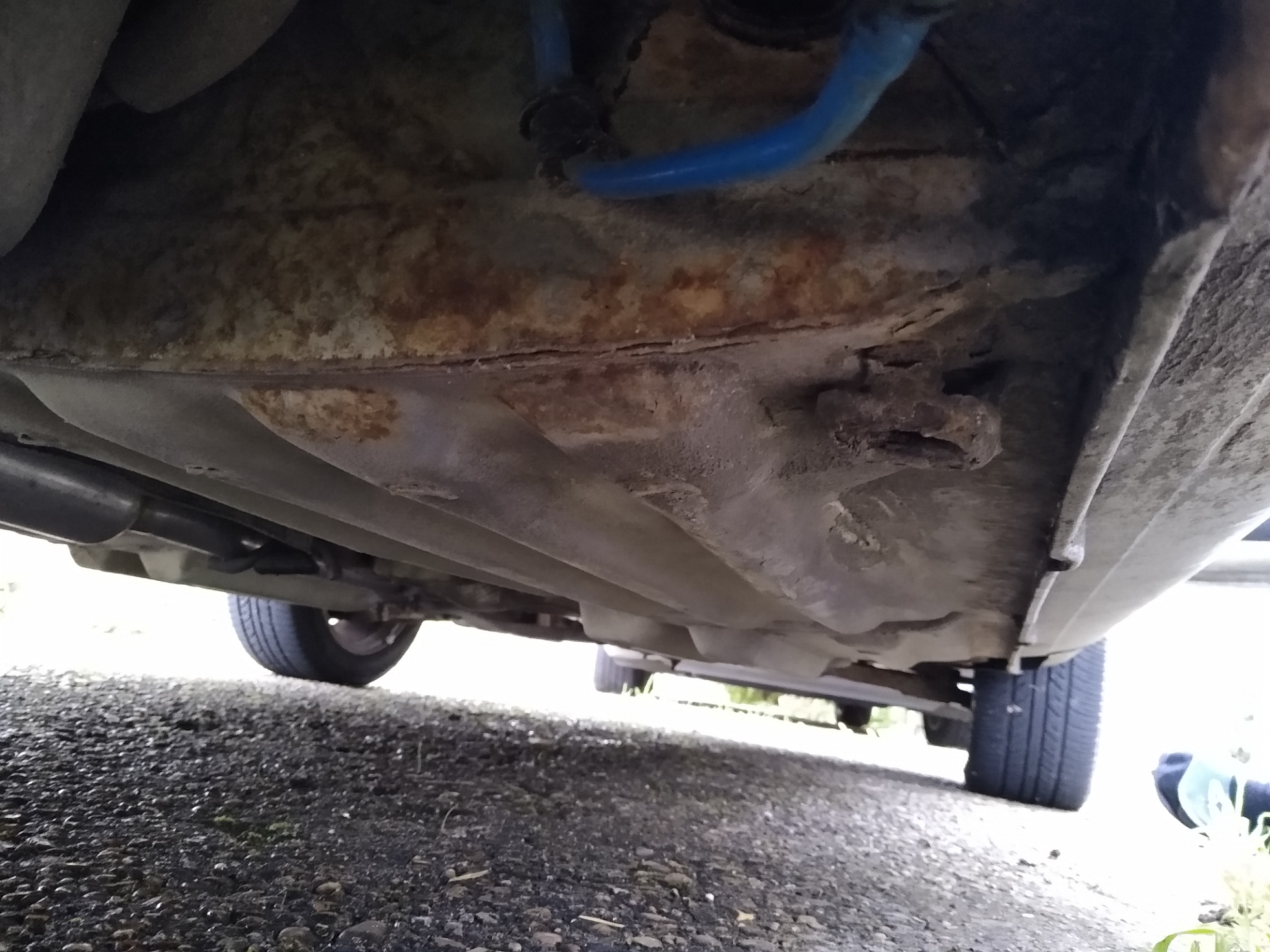

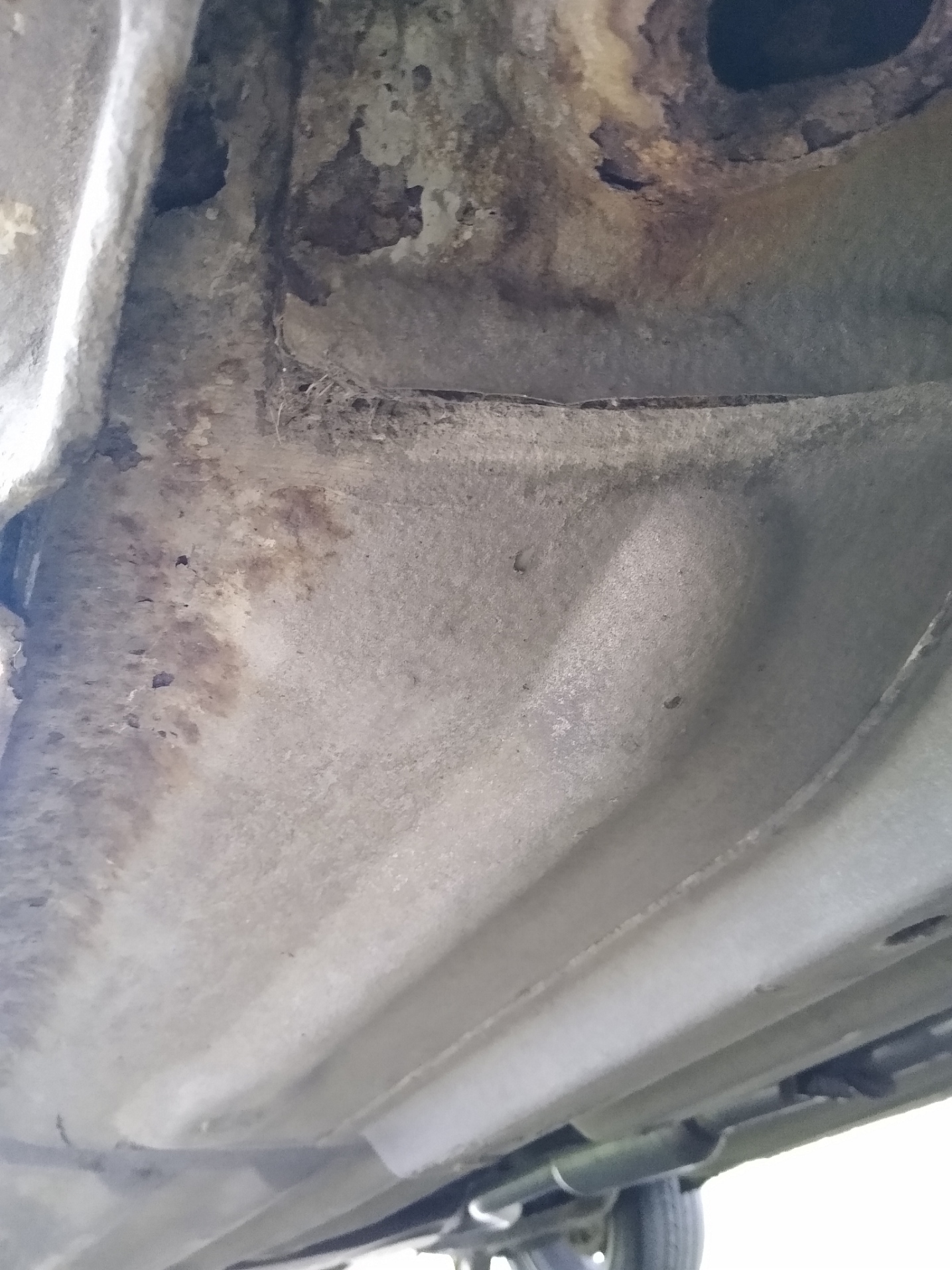

I'm not trying to be funny or anything, but could you please show me where they are supposed to be on these pictures, I can't find any drainage hols on mine. I even took the carpet up in the front and couldn't find anything on the inside either. Just a lot of soggy sound proofing.
I checked both of them, the one that leaks and the one that doesn't, on both sides.
Am I even looking in the right place, or have I completely misunderstood what I'm supposed to be looking for?

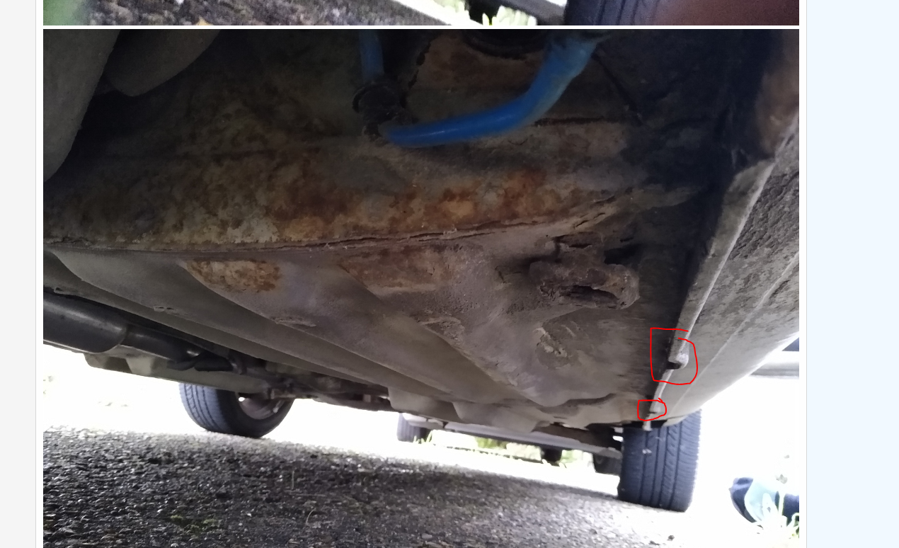

yeah along the sill, View attachment 453844
poke through them, should be holes there.. or pour water in sunroof trough and see if water comes out them.
I've actually already sealed my sunroof up with rubber strip, so I can't try this as the water can't get into the gully any more, but I did try to clean those holes out and nothing came out so I presumed that I was mistaken and was cleaning out the wrong places.
I've since found that this was a red herring, the water is coming from a rusted hole under my battery tray into the footwell.
