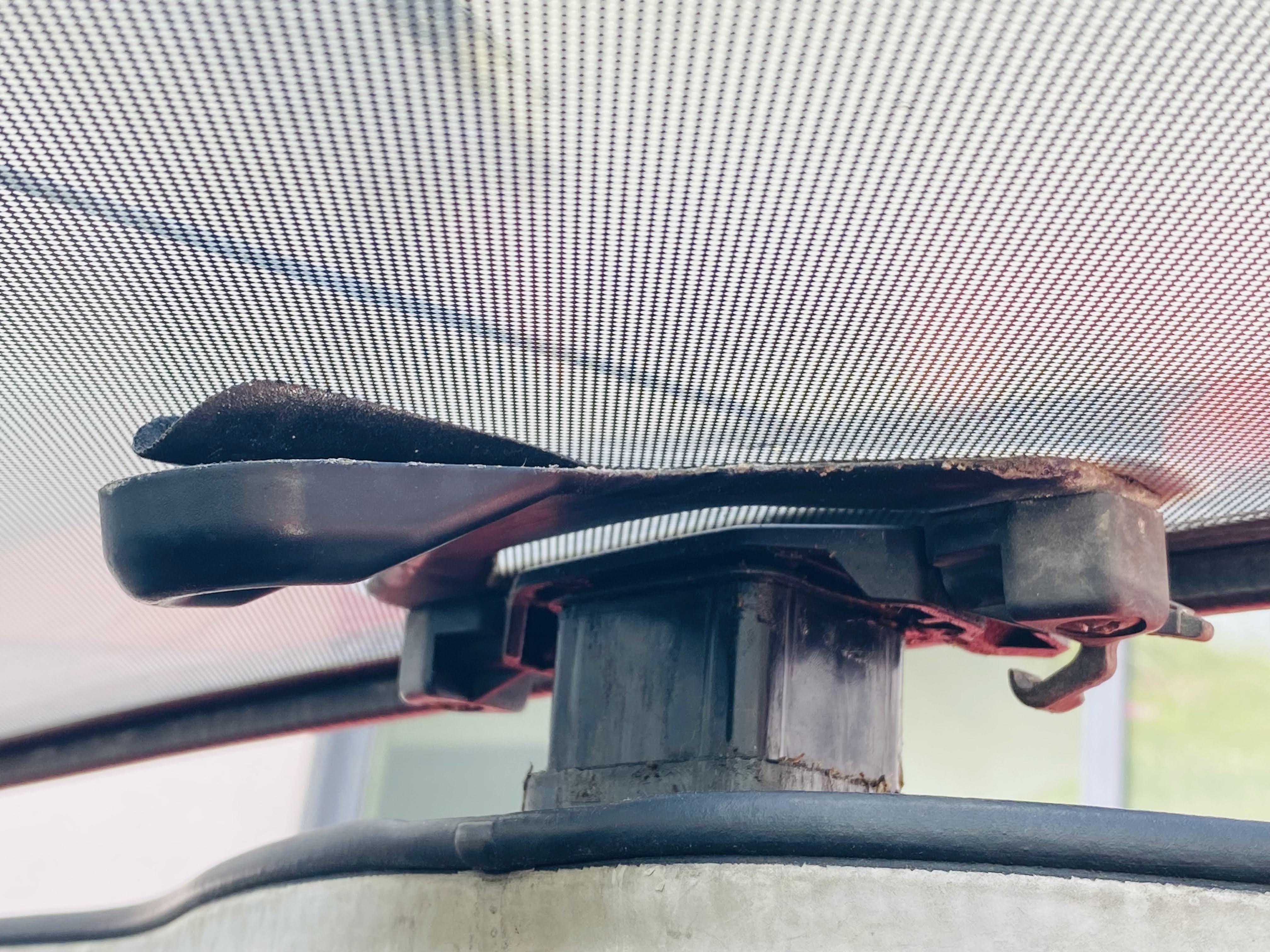

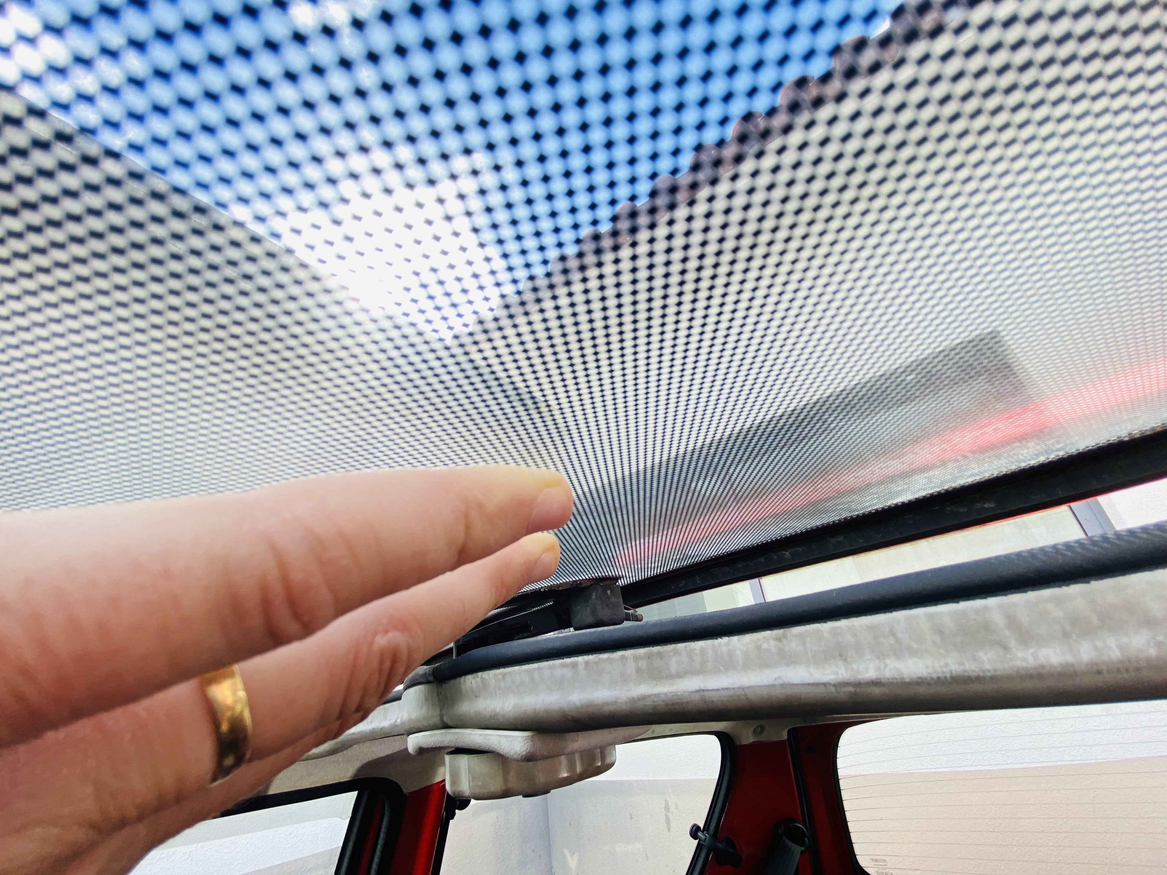

I have a question about my "new" Seicento Sunroof.
I think in my seicento sunroof is missing something, because it is a little bit loose, and when I close the driver door the sunroof opens :ROFLMAO: and that is not normal.
Even when it is closed I can open with my hand up to 10 cms.
I have here some photos.
I hope you can help me with some information or part that is missing.
Thank you

I think the sunroof is designed to be removable? Does it explain in the owners manual?
Or maybe the winder mechanism is broken?
From what I can see, the knob in photo 4 is supposed to raise and lower the roof as you turn it.
If you can't tighten the knob so that the roof stays closed tight, then the regulator (as it is called) is broken.
The knob may be rotating on the regulator and there a way to fix it so that it engages again.. but the regulator itself seems to be just one single part (735248585, if you can find one).

Looks like something has broken or possibly come apart, take it off & inspect it, i had to replace my one before & as another member mentioned you can actually take the whole sun roof out.....
