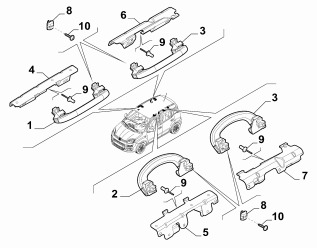

I want to fit the sunglasses holder that goes in the place of the handle. Only thing is my panda doesn’t have a handle on the drivers side. Does anyone know if the screw holes are under the lining for it to still fit to?
Model
0.9 TA
Year
2013
I would have thought it would be more effort for fiat to make panels without the screw holes than to just make them all the same and then fit the handles if spec, so I’m hoping the holes are there.
I added this to mine and the brackets were not there from new, that said I didn't even have a drivers grab handle. I also added 2 riv nuts to bolt the brackets in as they're riveted in at the factory, and I didn't have the correct size rivets
Got the lot from my local fiat parts department and wasn't too expensive, as the car's gone, I don't have the receipt with part numbers.
See below.
