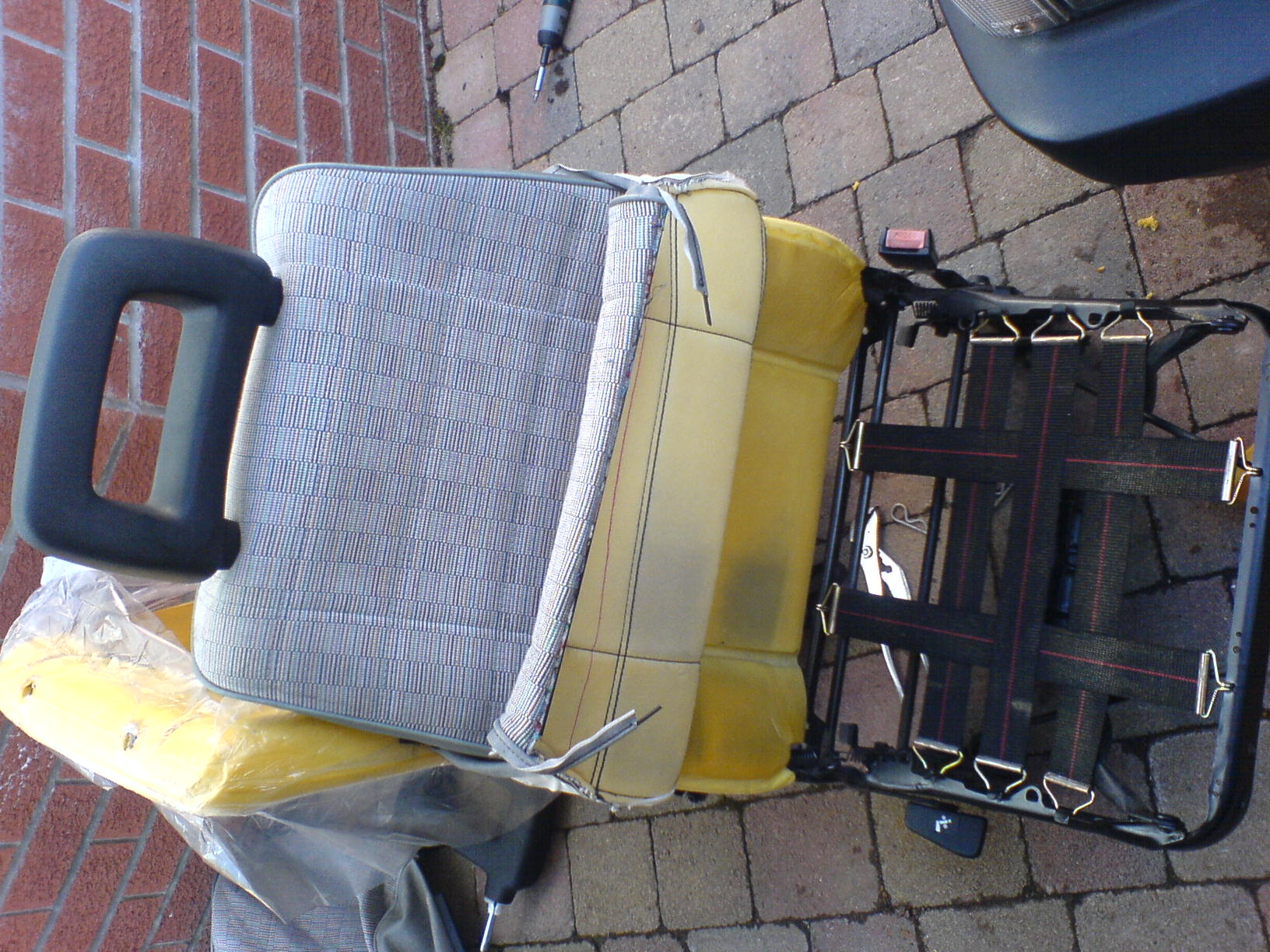

Sylvia's front seat was collapsing as the back rest would move without touching the leaver and I had a spare seat but it was a different colour.
Thus a lot of 'peeling it like a bananna' took place this afternoon...

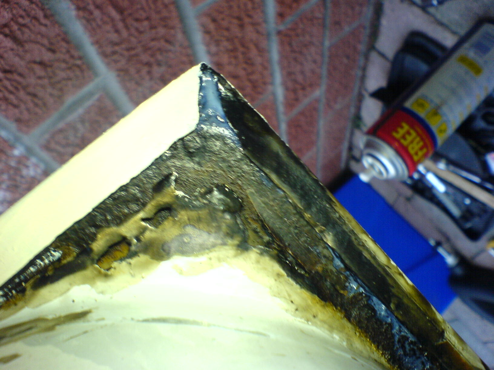

Rust - There's rust in both doors so it's got the wire brush treatment, rust converter and then some fancy German anti rust wax that I'd got for juppy. There's a couple of holes but hay, it will let more water out so that's good. There was a couple of bubbles on the lower parts of the door and sills but again we wire brushed and then put on rust converter and then primer. Its not too noticeable as there's lots of writing down there to catch you eye first. Whats bad is that there is a hole in the scuttle under the screen and it will let water in. It's right under the rubber so more rust converter was applied and I'll see you about it Stuart.
Seats - They went really well, I broke a few clips but it's not noticeable. If anyone has the bit of plastic that goes round the seat lifting handle I'd be very happy to hear from you as all my spare ones are broke too. I don't know if you noticed or not but I put some extra padding in at the base of the backrest as there seems to be a steel bar that digs into you lower back on long journeys. It's a bit odd at first driving but it's much more comfortable. The down side is that the spare seats and foam came from juppy so he looks really bad at the min with missing/ripped seats. I'll not put any photos up cause if Richard sees them I'm in big trouble!
