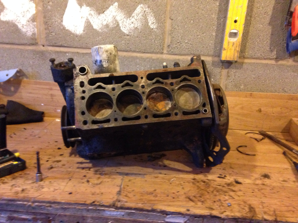

the 903 and 899 are basically the same engine they fit both the same mounts and the gearbox will fit both 903 and 899. bottom end wise, i could not spot one difference between the 2 engines.
