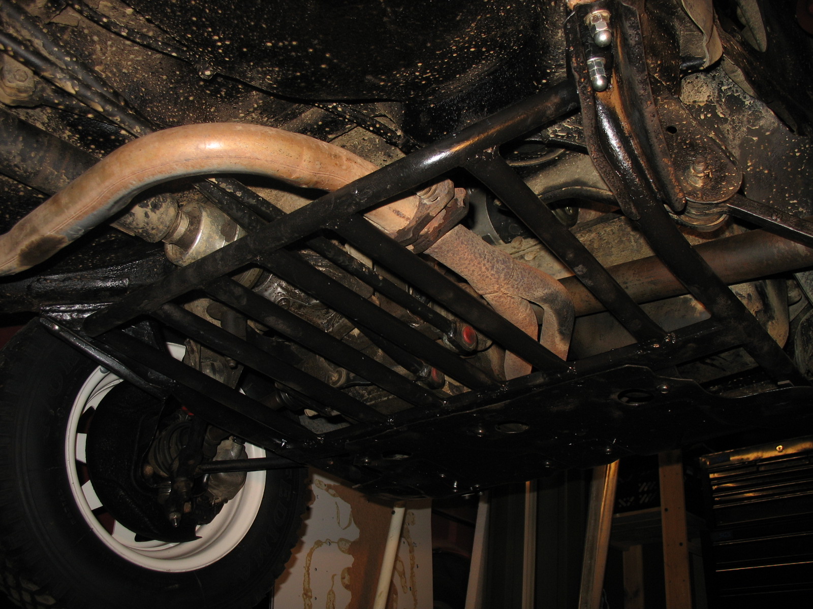

Thanks for the answer, just to make sure I've attached a pic of the structure thingy.
Would this require the modification of the cross member etc?

Hi,
2WD don't have the rear mounting points so they would have to be fabricated and welded on to the cros member
Or you could do like here, and bolt it down to lower arm mounting bracket with some "L" brackets - won't give that much protection any more.
https://www.fiatforum.com/panda-classic/87948-rat-sump-guard-modded-fitted.html
Next think is 2WD don't have the front mounting points on the radius rod front mount , this would need to be fabricated as well.
https://www.fiatforum.com/panda-classic/317342-seat-panda-terra-25.html
4x4 mounts for the sumpguard, and my modded sumpguard.
PS:
someone's idea of fixing 4x4 sumpguard to the 4x2 car, not the best one, not the worst, just simple "bolts through the metal" at the back, and some metal welded at the front. From panda raid member car from Spain.
