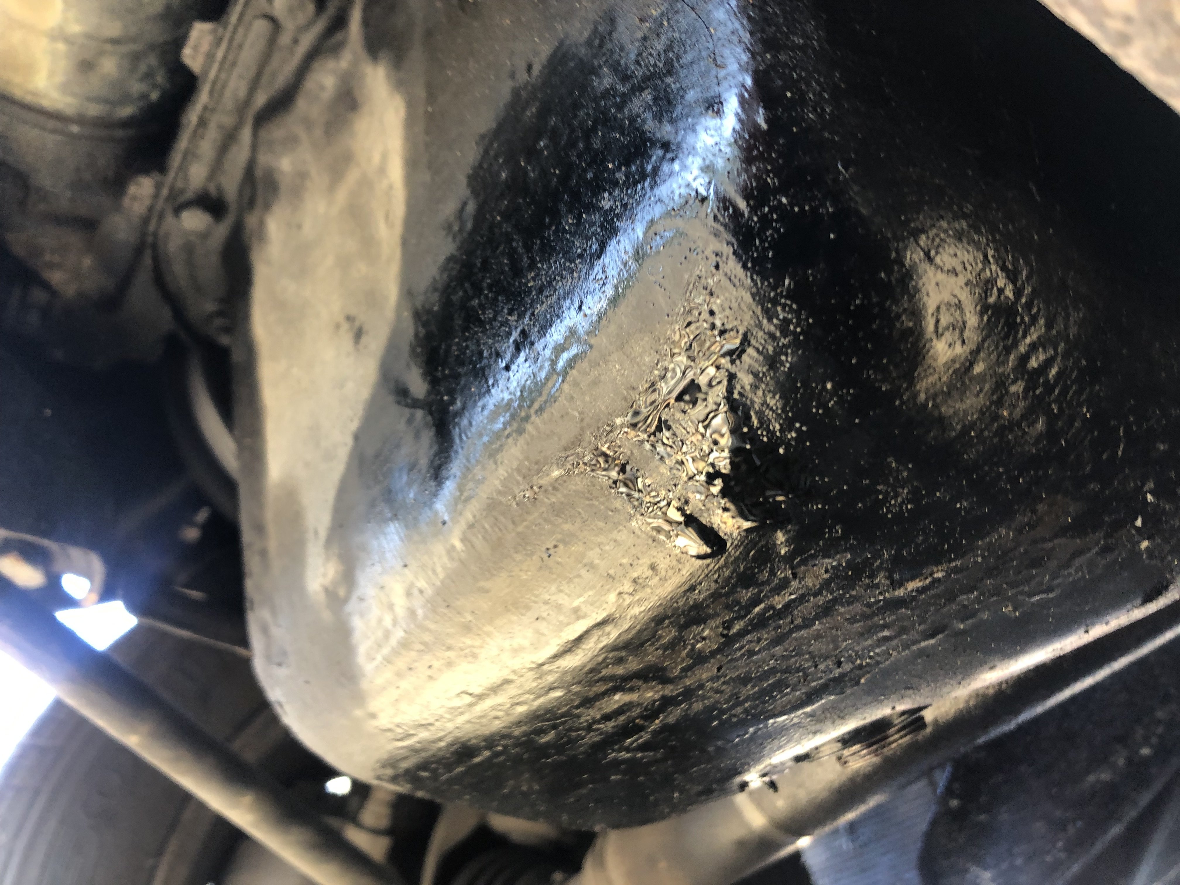

Today I decided to finally tackle my oil leak after I got sick of the ever expanding black puddle on my driveway. I replaced the valve cover gasket, which was leaking, changed the oil and filter, and job done.
Except while I was underneath the car I noticed that whilst the valve cover was leaking and causing quite a mess up top, the majority of the oil underneath was coming from elsewhere. In fact, it was coming from a hairline crack about halfway up the front of the oil pan. So, I need to drop the pan, and replace it and a new gasket (and my brand new oil...).
Is there a guide on how to remove the oil pan? Do I need to drop the exhaust downpipe to get it out, or is it as simple as unbolting all bolts around the top of the pan, then wiggling it out? Thanks!

I’ll check that, but there’s definitely a crack in the pan. Pushing against it causes some drops to appear, so it’s pretty certain. It seems to leak the most when the oil is hot, probably the metal expands a bit and allows some seepage. I’ve added a photo, it’s a bit tricky to see but you can see the crack starting at the top, and then the drips where the oil flows down and collects at the bottom.
Annoyingly one of my valve cover bolts isn’t tightening all the way, so I also have a bit of leak from one corner up top. Might need to have a go at thread repair.
