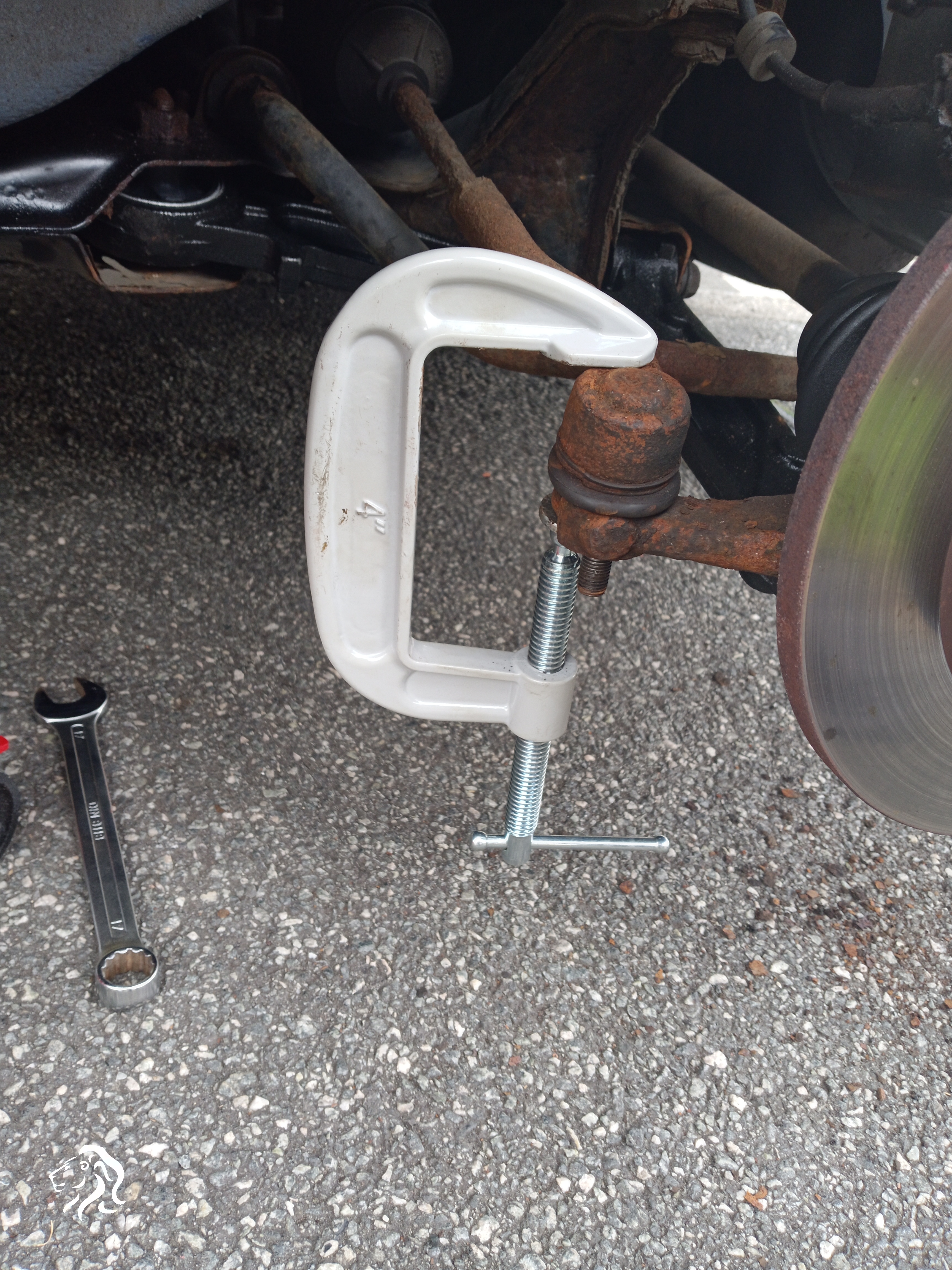

Ah, worked it out. So there you can see how I used the g clamp, and it worked perfectly! The pressure stopped the tread turning, and there was room to get the spanner on the nut. The track rod end is still serviceable. Result!
