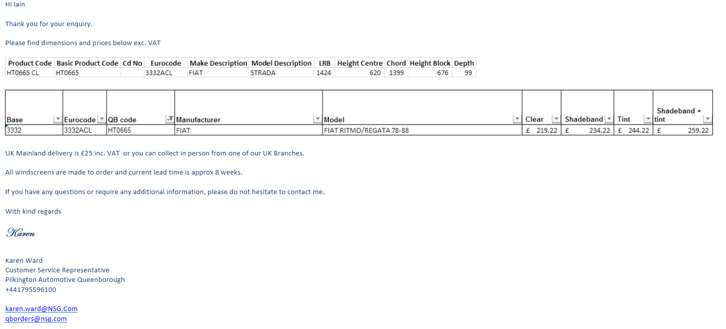

a) how much did it cost?
b) did they make from scratch using resurrected tooling or did they cut an existing current production screen down to size?
See attached. The screen cost 260 approx., and there was an 8 week lead. They can supply all other glass for the 130TC as well, as far as I remember. They make it from scratch, from the original blueprint. Karen Ward (email in the image attached) is the person you want to speak to, she sorted it all out, including the pick-up from one of their warehouses in Glasgow (I transported it myself to a garage, who fitted it for me).
