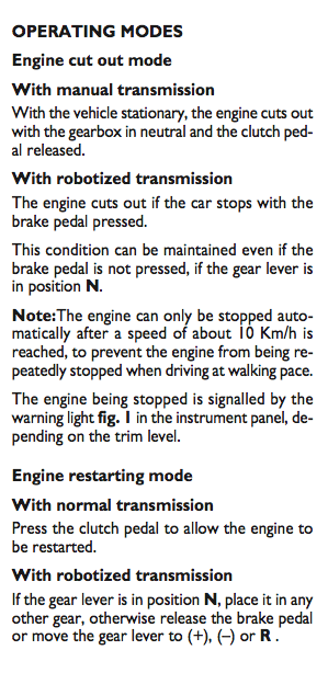

Found this:
It's true, the Dualogic S/S cars encourage you to leave the foot brake depressed.
Absolutely stupid design IMHO.
The handbrake has a switch, so why not use that in parallel with the foot brake?
Dualogics can happily be left in gear engine running stationary handbrake on, so why not use the handbrake?
Cheers,
Mick.

I totally agree, Mick. The behaviour fits with the title of this thread though. It's weirdness, isn't it?
