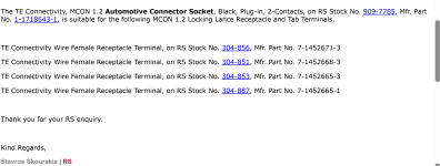

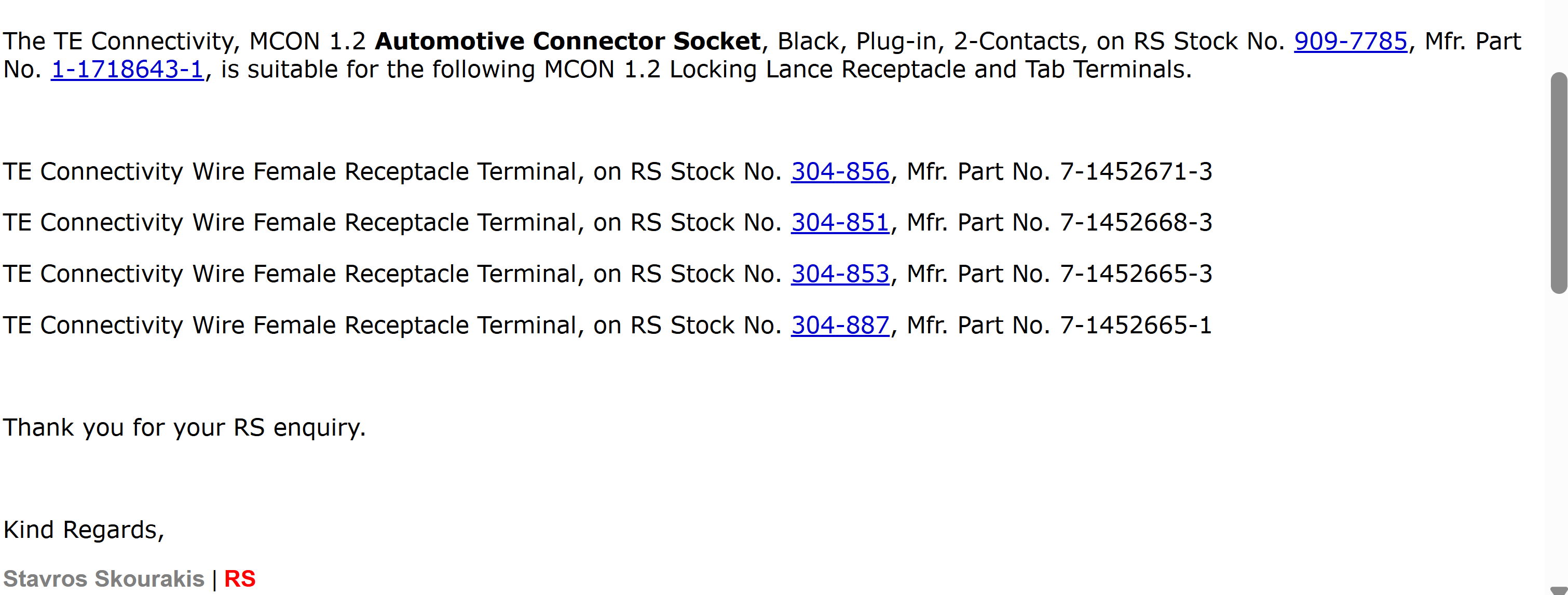

I have received terminal advice from RS, Please see attached. I went with
this option as it is rated at 10amps, the rest being rated higher. I do not know what the current in this circuit is but I would be surprised if it was over 10amps as it goes to the ECU and it has thin gauge wiring. Selecting one of the other options would be totally suitable from the current point of view but it may well be designed for use with thicker wires and not grip properly when crimped. On the subject of crimping none of mine were suitable so I crimped with needle nosed pliers. I am happy to that as I am a retired Electrical and Electronic Engineer.
TE Connectivity Wire Female Receptacle Terminal
Stock no.:304-853
