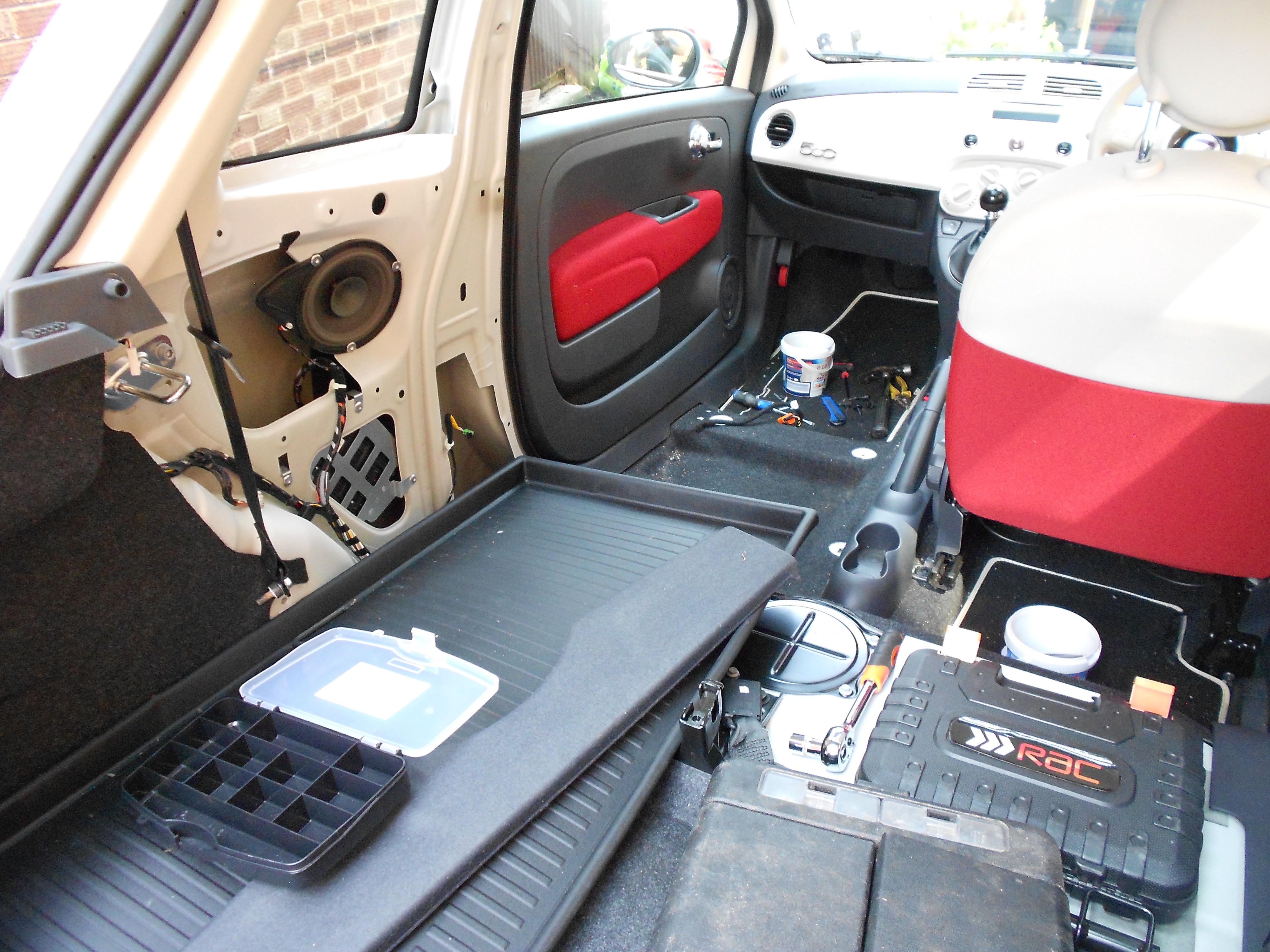

Any idea where the Blue me module is ? And the car runs really well. Just the 3 faults as listed. One which was sorted on disconnection of the battery, which, in theory could have corrected all 3 faults. Theory being the optimistic word. Under the bonnet you can see how well it has been kept, by looking at it, there seems to be a lot of new parts added by the main dealer, which is why I paid double the price of it's book price. I hate the start stop function on these cars, but I was told." You can tell a car is running correctly, when this works," by a mechanic, So i just thought it would be an idea to ask on here.kind regards Vinny

Hello,
@26vinny
The Blue&me module at Fiat Qubo (model 2012-2015) is under the driver's seat. It's very easy to remove because it is bolted with 4 screws. You'll need only a Philips screwdriver, a short one in length or something flexible. You have 2 choice on one hand you'll buy a secondhand Blue&me module with the same code or you'll try to repair your's.
If you choose the first option it's necessary to code (align proxy) the new one on the car. On the second choice you don't need to code it.
