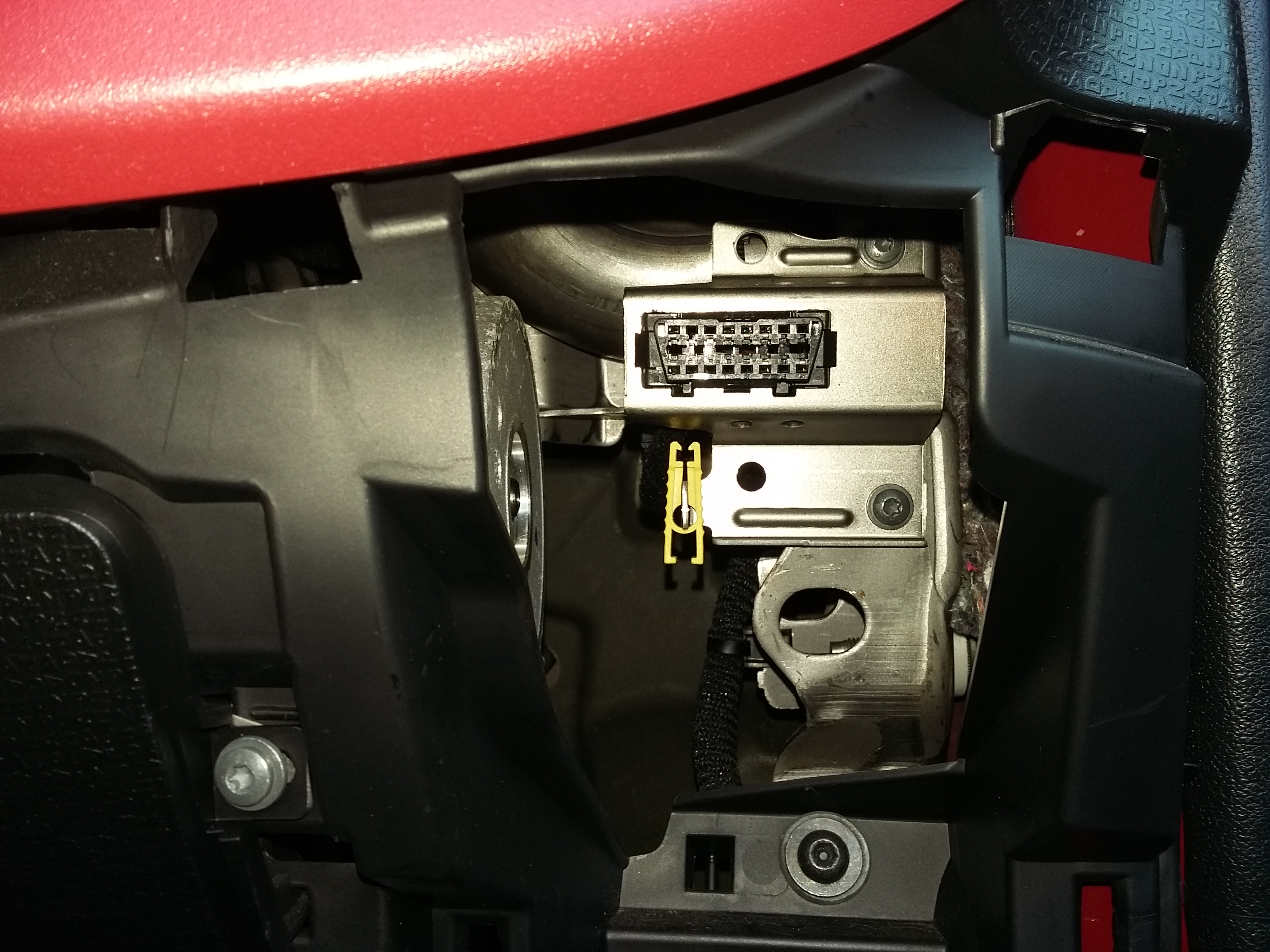

Was the plastic cover to the right next to the door under the vent removed?
Exposing the OBD port..
Potentially turning off the Immobiliser requirement
Image is a panda (but virtually identical)

Did you lock the car with the remote, post 2012 ish cars the OBD2 is dead until a valid signal is received, I suspect someone interrupt the signal as the car was locked
Not sure how true the port being dead part is given how many 500s and especially arbarths are stolen each year via bypassing the immobiliser via obd port
Just need ignition bypassing via breaking the lock like has happened to the op
