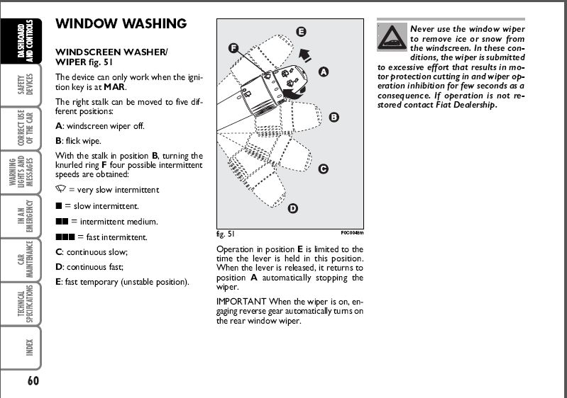

Does the stilo only have 2 wiper settings, or am I missing something?! Intermittent and slow!! There doesn't seem to be a fast setting for heavy rain?!
From the Stilo Handbook:

Got it. It was stuck! Put some wd40 in, wiggled it and it's fine now. It has spent a lot of time abroad, and probably not been used much...poor thing is now in Scotland...never off. Thanks for your help.
