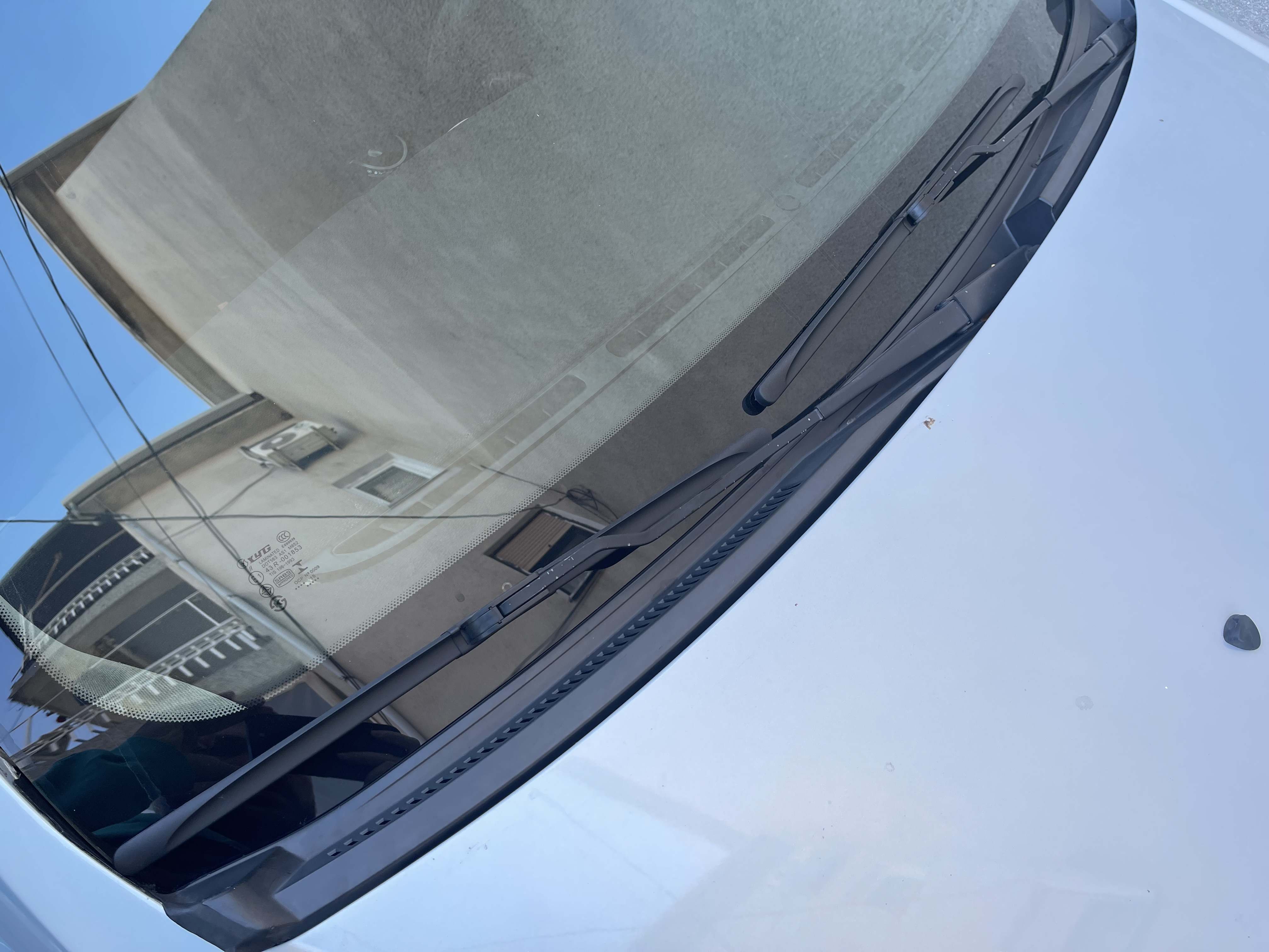

550mm/480mm praxis air 15. Fitted yesterday
OMG, is it touching the side?
Yes, i noticed that yesterday. Before these, i had 440mm on passenger side, but everyone reccomends 550/480 for stilo so i bought 480.
Tonight was first rain and i got some annoing quiet tap noise when they are coming down from up somewhere on the middle. It freaks me out but i dont think thats from passanger wiper touching the end, because the noise is coming from the middle way…

I would go with 550/475. Also I think i can fix my touching blade tommorow by recalibrating/moving arm by 2-3mm up.

Aren't the wipres touching each other?

just sprayed wd40 onto wiper arms bolts and it seems it fixes my noises. Time will tell...
