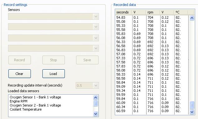

Here's mine on a warm tickover- look at the rpm - hardly moves. That's how yours should look. This is with aircon off. With arcon it should be just as steady but a little higher
It doesn't sound like the garage is capable so I'd take it somewhere better, a specialist maybe who can do a running diag on your engine and see what the problem is. If you haven't already done so, do a careful throttle valve clean up as described in the Stilo Guides
