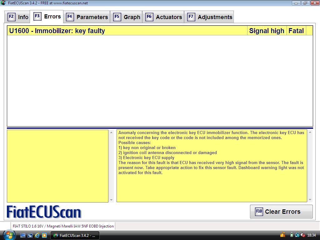

clear the fault and then remove the car battery for a few mins, hopefully that may clear it, if not you will need to find out what ohms resistance the coil should be and test it.
the short in your ecu may have burned the pick up coil out. hopefully not though.

Read the comments in you FES screen print - that might be an explanation why your keys are not recognised , the antenne works with a high frequency (around 125 kHz) and the signal will be disturbed when there is a short-circuit to V-battery or negative.

Last night I checked the antenna. When this is unplugged, an error shows. Tested with multimeter and there is minimal resistance and has 2.7v feed to it so I'm pretty confident this is ok.
I thought as the CAN Network error had disappeared, it may start using emergency start procedure. When entering the code, it does not flash to confirm it was accepted and still refuses to start. Bad news, the U1600 fault has returned since attempting to start the car and does not go away.
