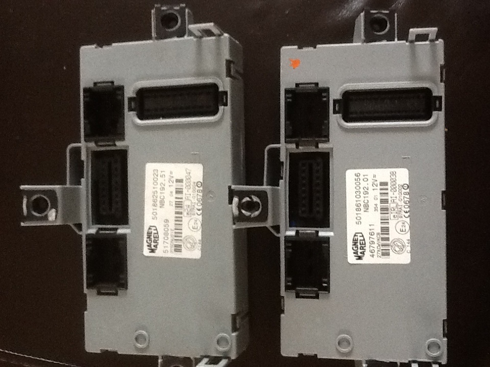

Hi, can anyone help, on the the attached photo is my body computer at the bottom and one I got from ebay, the numbers on the barcode sticker do match is it possible to get the top one mapped to my car? Also does anyone have any idea roughly it would cost to get a body computer mapped to the car?

body computers are ordered by chassis number so unless you also have the ecu, keys,locks from the car the body computer came from it's a waste of time no matter if the numbers match or not.
Thanks very much T14086 now you have explained that I now know I need to get my body ECU repaired. Bri1232 if you had put a helpful answer like T14086 on my original post I would not have started another one!!

when the numbers on the BC match it's possible to swap the microprocessor or eeprom inside to transfer your car's specific data.
This should be done by somebody with good (de)soldering skills, it's not a simple DIY job without the proper skills.
That way the donor BC would work just like the old one (with matching type numbers)
But of course you should check all external factors before doing this - you have to be 100% sure your problem is within the BC.
