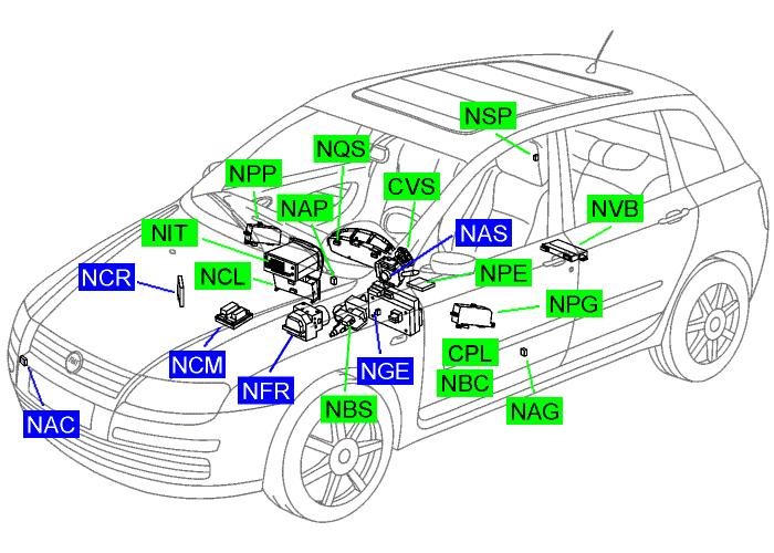

hello could any one help me i have a airbag ecu light always on. i took it fiat and they told me the ecu was faulty. new one £300, i have sourced another working ecu same part numbers but i am unable to find where it is fitted although the manual shows it by the heater area still unable to find it any ideas please thank you

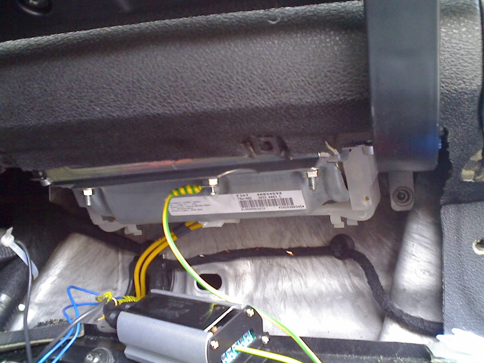

Take a look at my guide for a "space thrifty amp install" in the guides section for the Stilo. You will see the airbag module on one of the pictures there. Correct me if I'm wrong, anyone.
Morten.
noo, it was a small cast metal box with a multiway connector on one side, definately wasnt the airbag. If this was the airbag the passenger would end up with a cd changer in their face im sure.
ive got some car stuff to do tomorrow, ill take a picture of it and check the centre console while im there.

ECU is item number 2 on this diagram.
1 point to PNL :)
Dave.

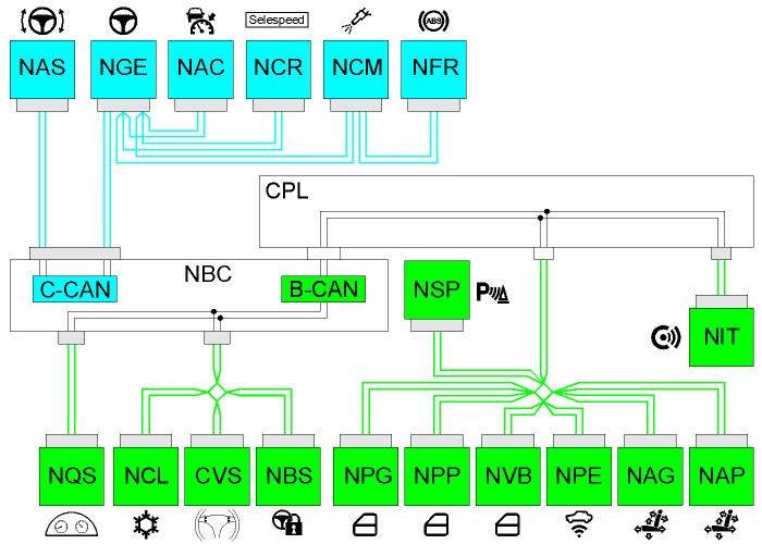

Hehe. there you go then. Ive got some diagrams which show the way various computers around the car are hooked upto the two can buses in the car, and their locations. Im not sure if the airbags are on there as im not sure if they use canbus or not for comms.
