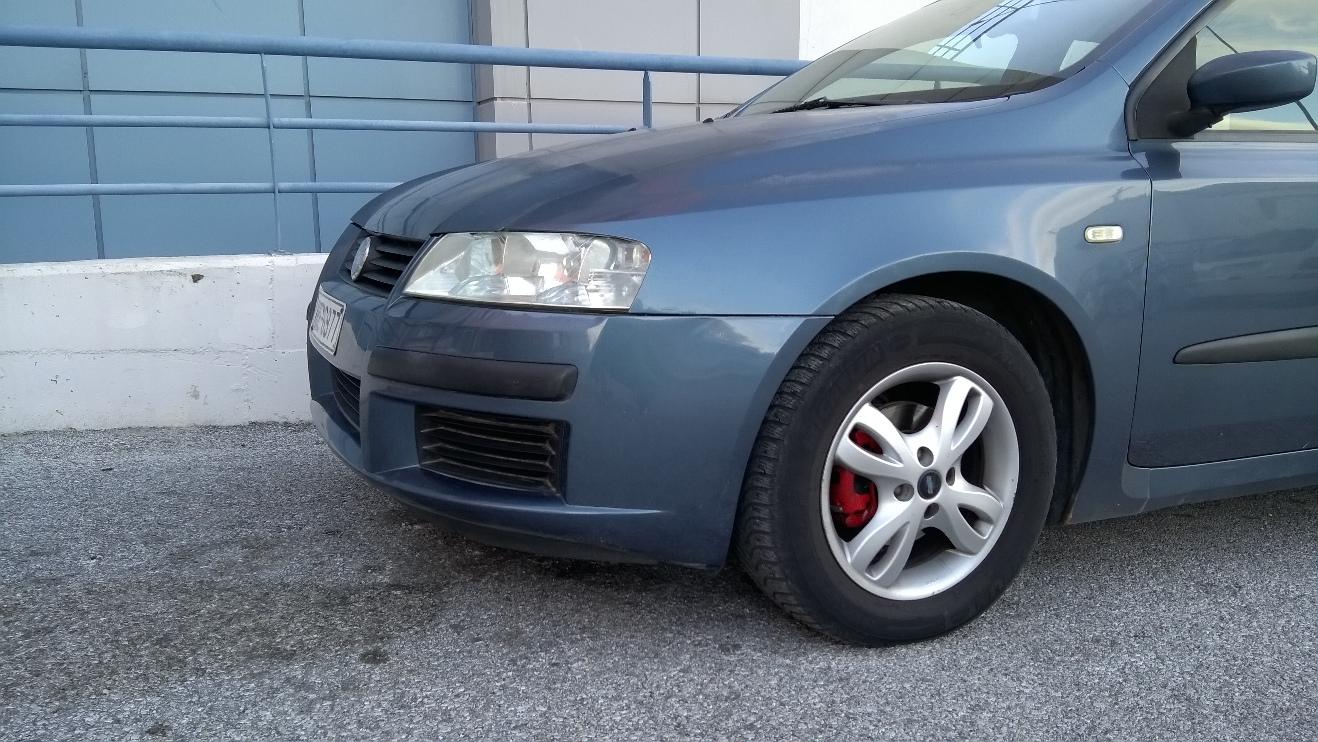

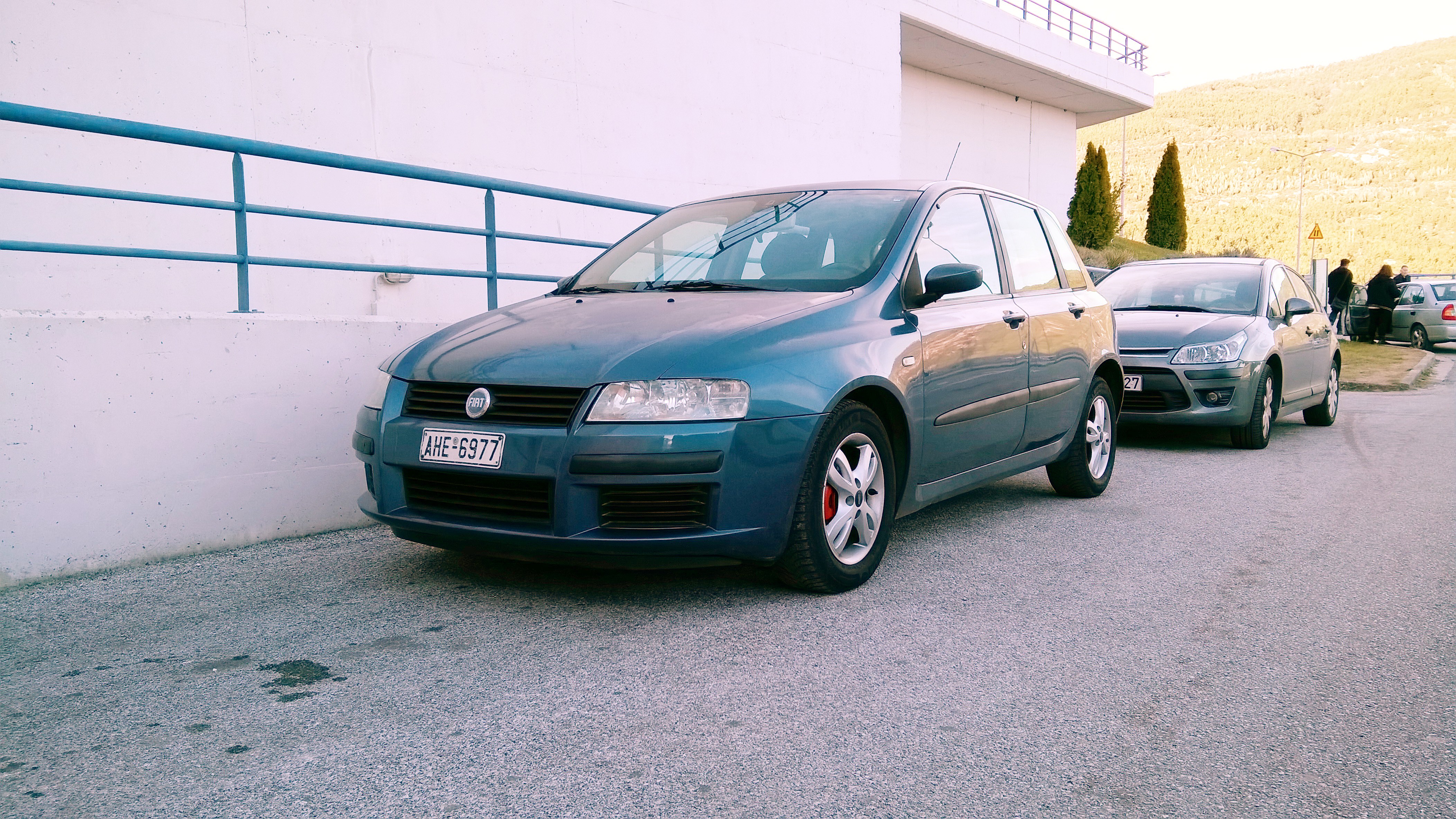

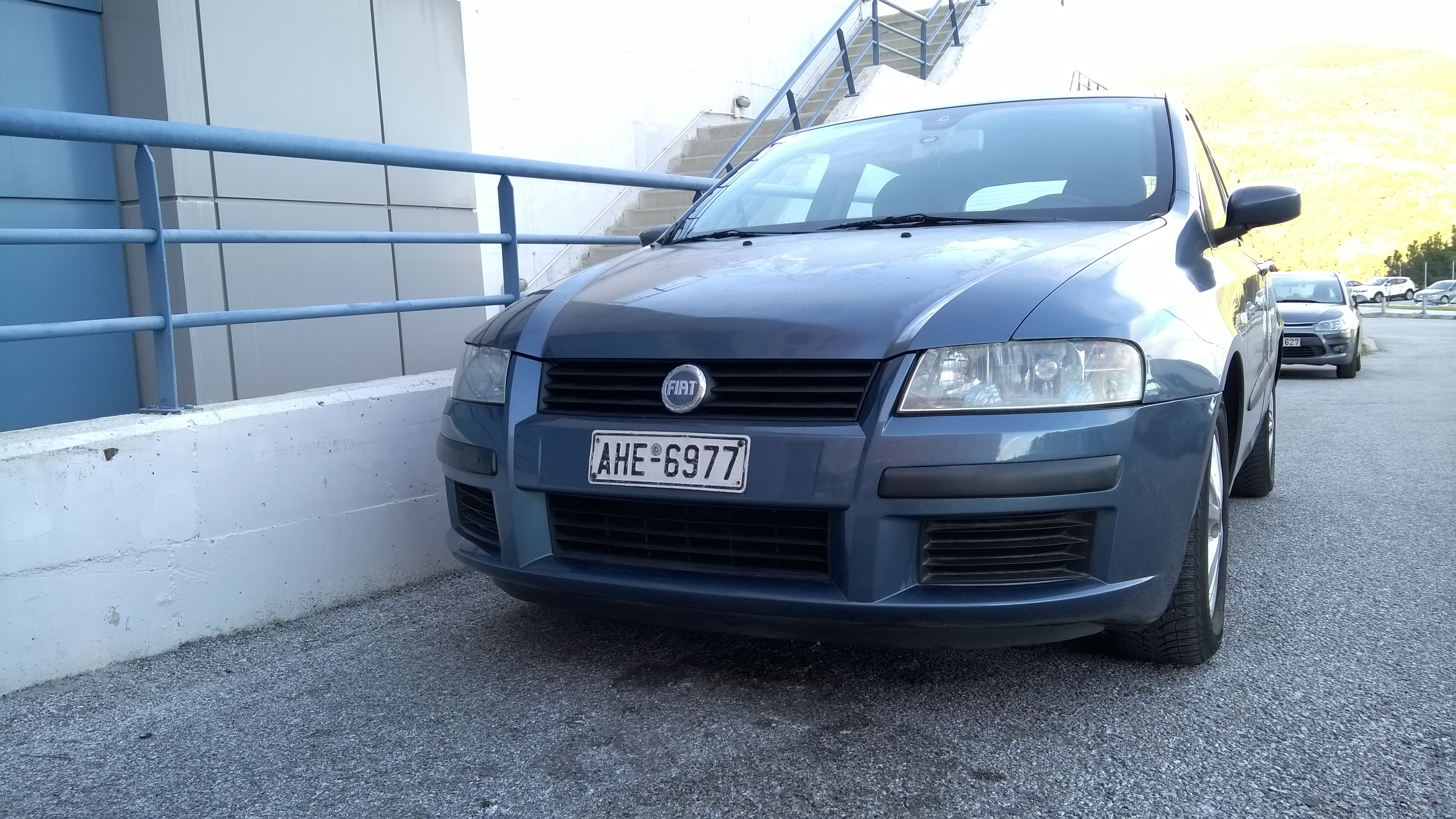

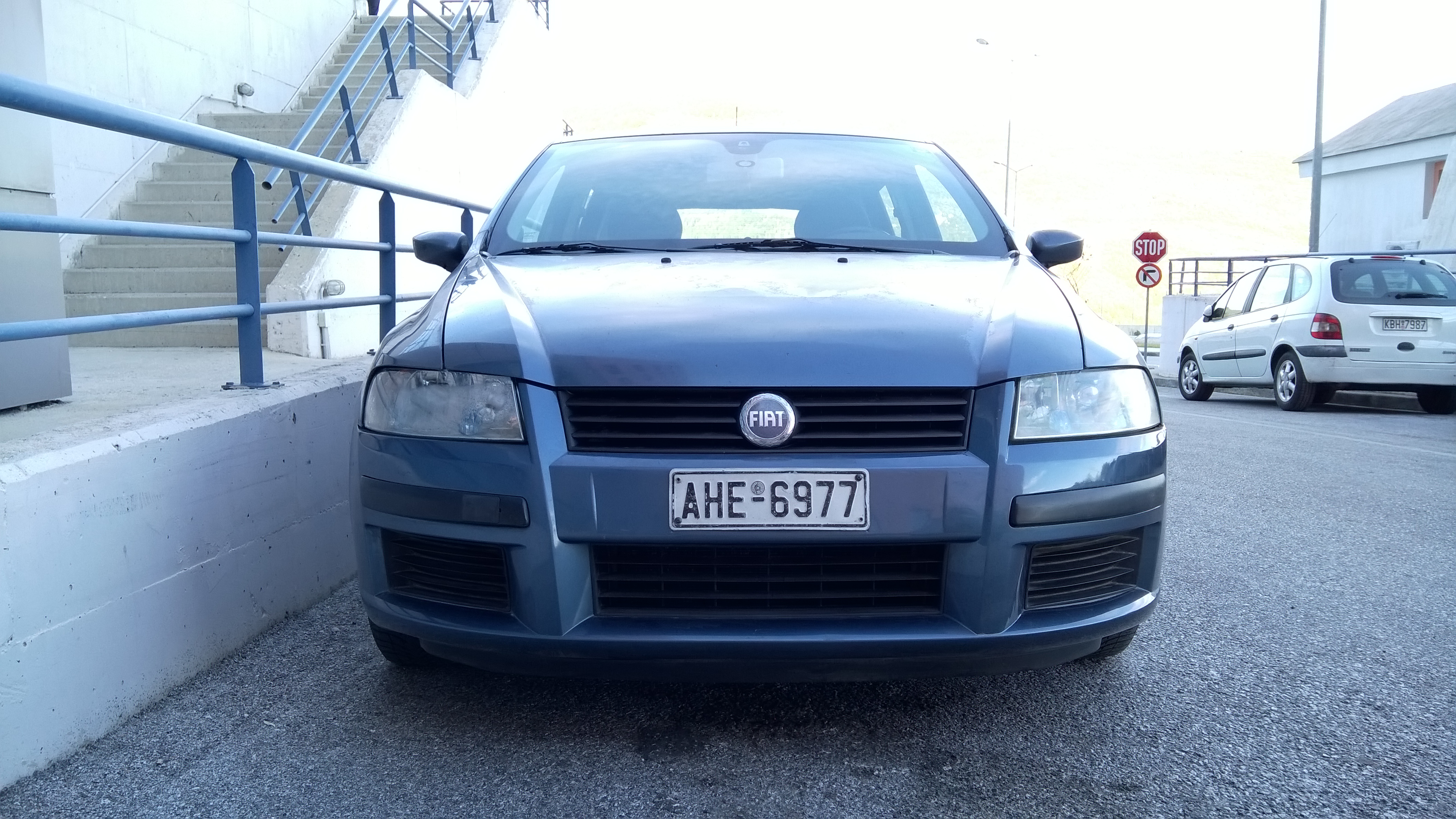

Ι was curious if its possible to swap the 5 Door bumper with a 3 Door bumper which is more attractive...I read that is possible so I tried it...
Here are some pictures...
The swap was easy just unscrew 4 torx bolt above front grill another 4 torx bolt under the bumper and 2 10mm bolts and 2 torx bolt in each wing side.
Took me under 30 mins for the procedure!
The result is good in my opinion and its worth it!
More photos from the bumper.I think that it's almost perfect fit except the line from the bumper meets the headlight.
