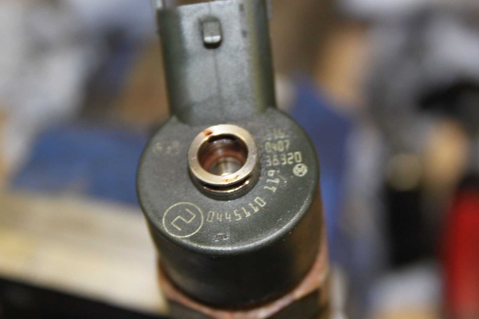

Have you programmed the car for the new injectors?
I know on the Alfa diesels, which should be same motor, you have to program the car with the injector codes. I wonder if this still counts for the 1.9 jtds?
See this video - appreciate this is for a 159 2.4 but it demonstrates the theory:
It's similar for the 1.9, 8 valve engine, but the injectors are only graded as 1, 2 or 3. The grade number is in a circle on top of the injector.

it seems I got faulty injectors. I have put my old ones back and car is running 100%........and the pre heat fault message has vanished.......
