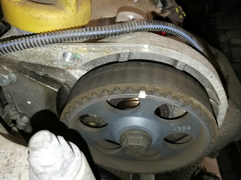

My 1.4 -07 Stilo is not starting any more. One day I was starting it, it just tried to start once and then just cranking. Cranking sound is now little bit strange and I'm afraid the timing belt has jumped one or more steps off, has there been this kind of issues with these engines? Timing belt is not snapped, that I've already investigated. Is there some original timing marks somewhere on 1,4 Stilo engines? It would be great if there would be image of this marks if there are any.
If timing belt has jumped one or two steps off, does it mean that the valves are already damaged?
From what you say, I can't envisage a failure mode which would allow the belt to say jump a few teeth, but then continue to function. Okay a knackered belt can shred a number of teeth, but if it did it wouldn't move when cranking (assuming its not broken and does move when cranking :)).
Consequently I would look to another cause, starting with fuel, ignition and compression.
The belt is moving when cranking, I took the belt cover away to see the belt clearly. Cranking sound is not metallic sound and there wasn't that kind of sounds when problem appeared first time. Cranking sounds fast, like it is missing pressures.
Definitely, I've to take it into garage first someway. I'm pretty sure that there has happened something related issue and that's why I'm asking, is there any original marks in these engines where to compare current positions of pulleys? Also I'm beforehand interested, can there be big damages already if it has jumped a teeth or two, is there any reason to play with it anymore? Or should I just send it straight to nail factory. :D
It seems to be 16v engine. :/ I looked under the belt cover again and I was hardly able to see some white marks on cam pulley and on head, these are possibly did by earlier mechanic? I didn't yet get enough visibility to crank shaft pulley to see is there any marks. Hope those will be found there.

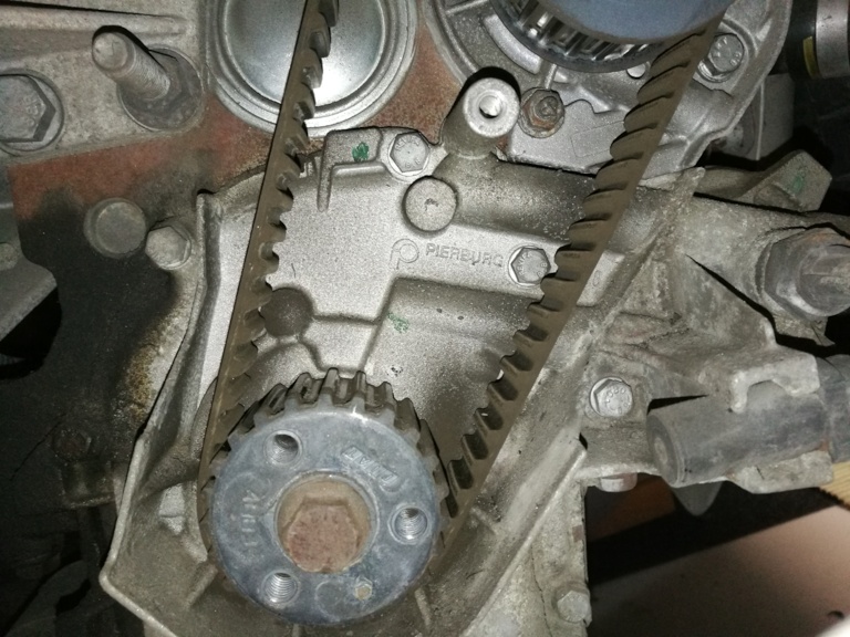

Also finally got lower part of belt cover away and got visibility to crank shaft pulley. I believe I was able to find marks that someone has earlier did there. Rotated cam shaft to old marks and checked what crank shaft pulley says then. I would say that I'm able to see it is in marks then:
attachment.php
attachment.php
Maybe it hasn't been jumping?

Hi
Great, test 3 confirm that cylinder 3 & 4 are consistent.
And also cylinder 1 & 2 are confirmed.
1.2 bar for cylinder 1 & 2 is good.
Timing is good or else none would have been good.

But anyway: It seems that I can confirm that the cam belt hasn't been jumping in my case.
