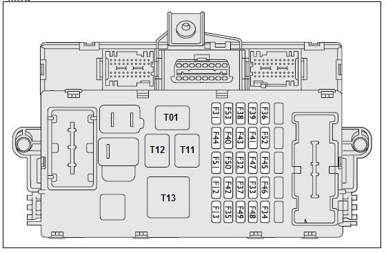

There is no conventional speedometer sensor on the Stilo. The road speed signal to the speedometer comes from the ABS ECU which gets signals from the 4 wheel speed sensors mounted in the hubs.
There's also no specific fuse just for the speedometer. The whole electronic instrument panel gets a permanent supply from fuse F37 (10Amp) and an ignition switched supply from fuse F53 (10 Amp), both located in the dashboard fuse box.
You can download a handbook from the forum downloads section here: https://www.fiatforum.com/downloads.php?do=cat&id=5

cheers , for that ,, its just my speedo as stopped working ,, not too sure why ???
If the problem was with the wheel speed sensors, you would have an ABS warning light on and a message in the display saying ABS Fault. If you don't have that, it's likely to be a fault with the instrument panel, possibly the speedometer stepper motor not working. All four needles have their own stepper motor to move the needle.
