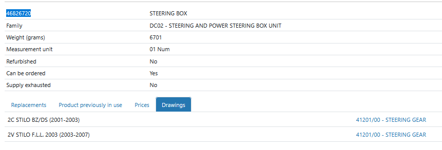

The forum ePER does recognize the part number, and lists it here:

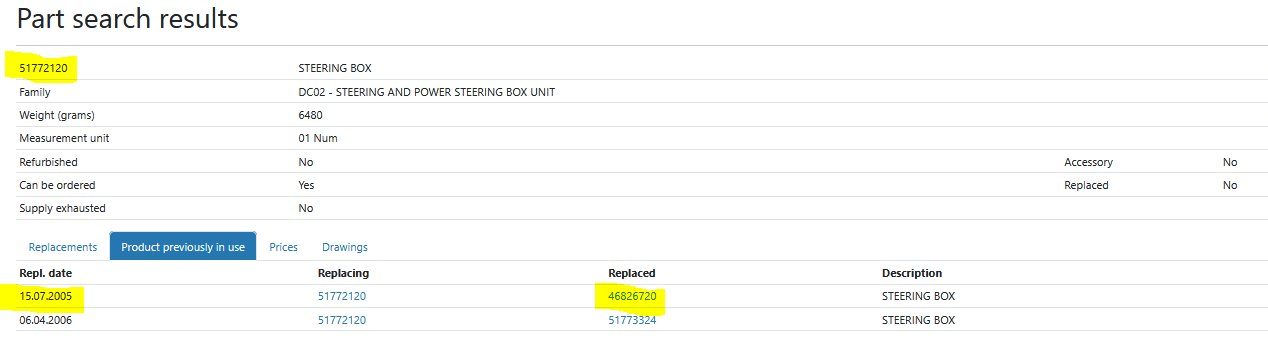

And looking at the other part number details (46826720):
It was installed together with two engines:
1,8 16v EUR4
2,4 20v EUR4
It is not compatible with the diesel engines nor the 1,2 / 1,6 petrol engines.
1,8 16v EUR4
2,4 20v EUR4
