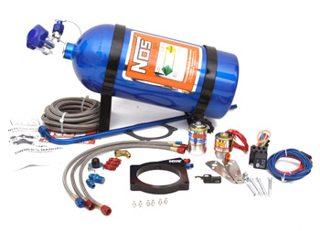

I like the irresistible compulsion for power.... :D but starting from a 1.2, I detect the triumph of optimism over the laws of Gravity, if not even Physics..
That beast will probably not work... but it might work... and it could even work well.. but, if it does not end in the smell of burnt oil spattered over the windscreen, and fractured pieces of alloy and steel embedded into the bonnet liner and through the radiatore, it will at best produce 75bhp.
On the other hand.. if the impetuous enthusiasm of youth cannot be taimed and if the car is destined for Valhalla... then at least it should die with a metaphorical sword in its hand.
You don't need one of those... ^ You need one of these... :D
