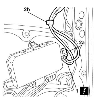

The door mirror itself isnt so much a problem but, unless Fiat put a connector somewhere else a bit more convenient,
then you'll need to get access to the door node to connect it up electrically which will mean removing the door trim.
have a look in the Stilo Guides up above for fitting door speakers as that explains removing the door trim
