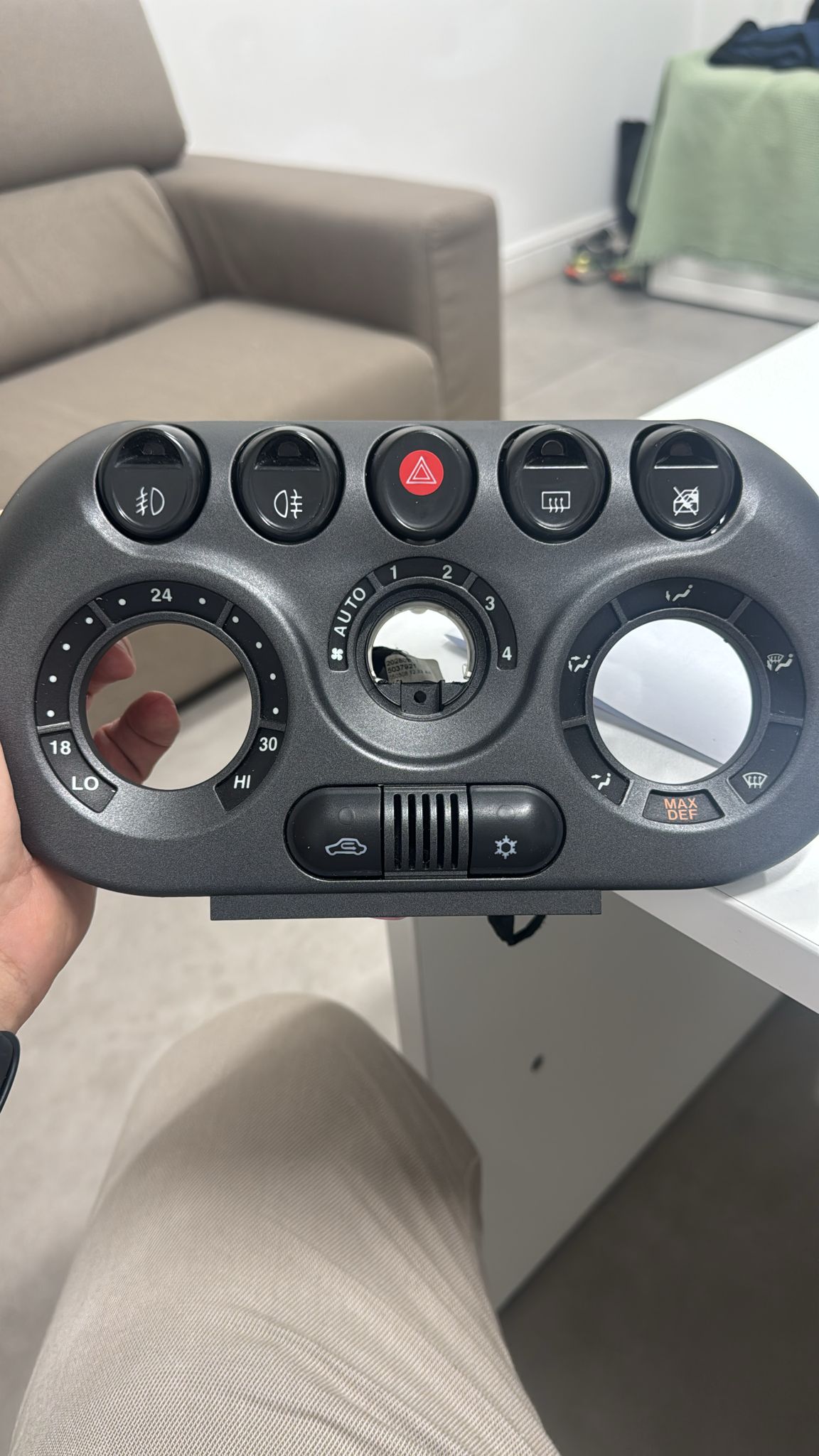

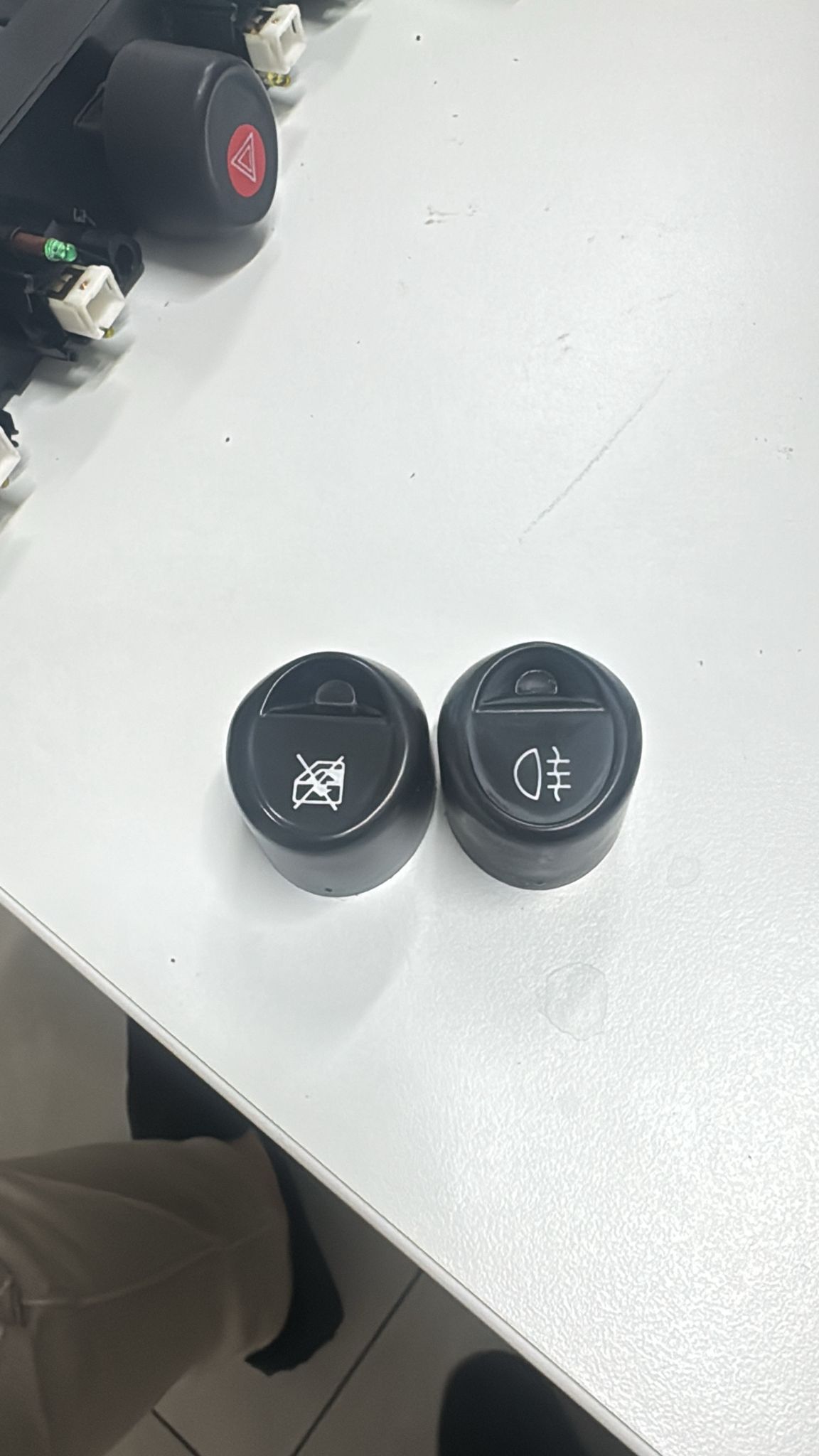

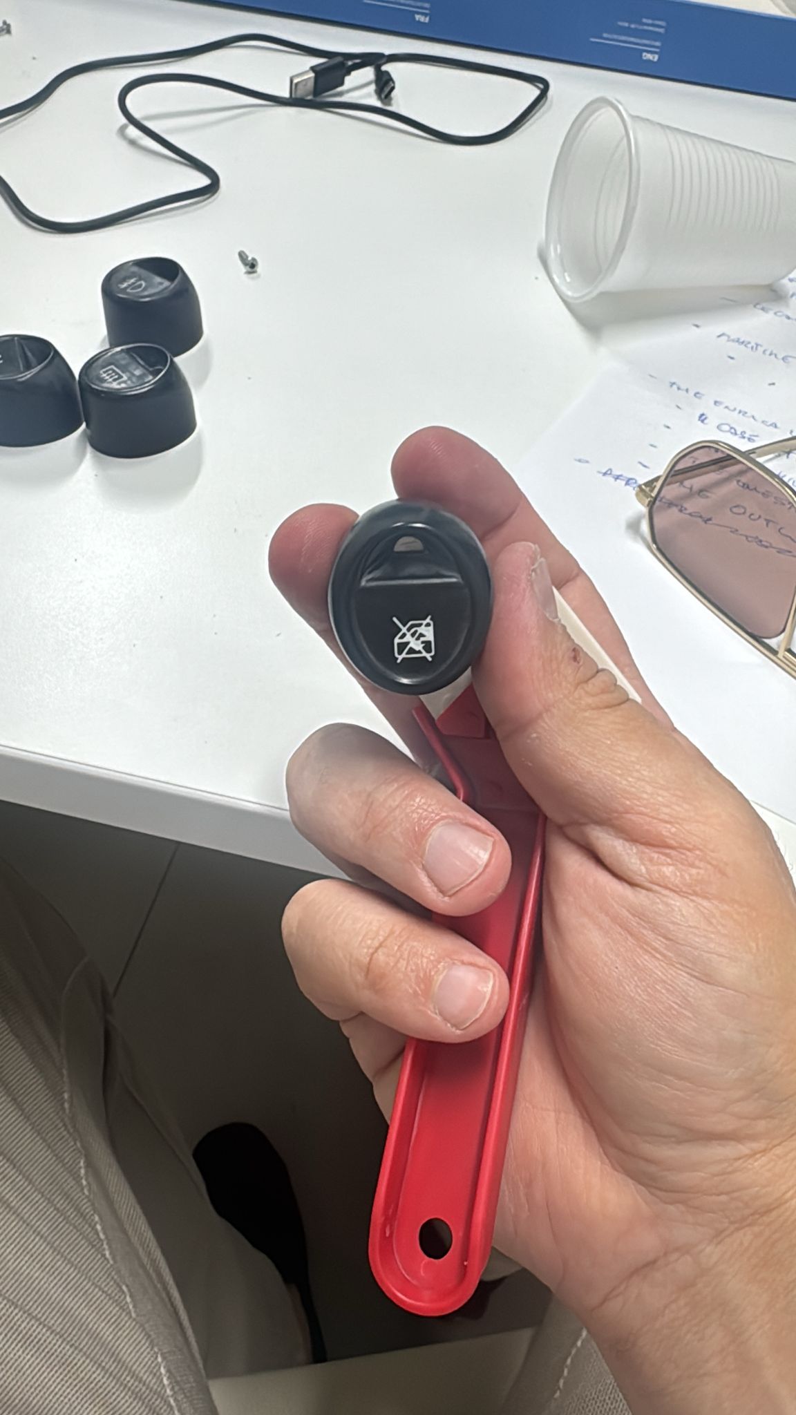

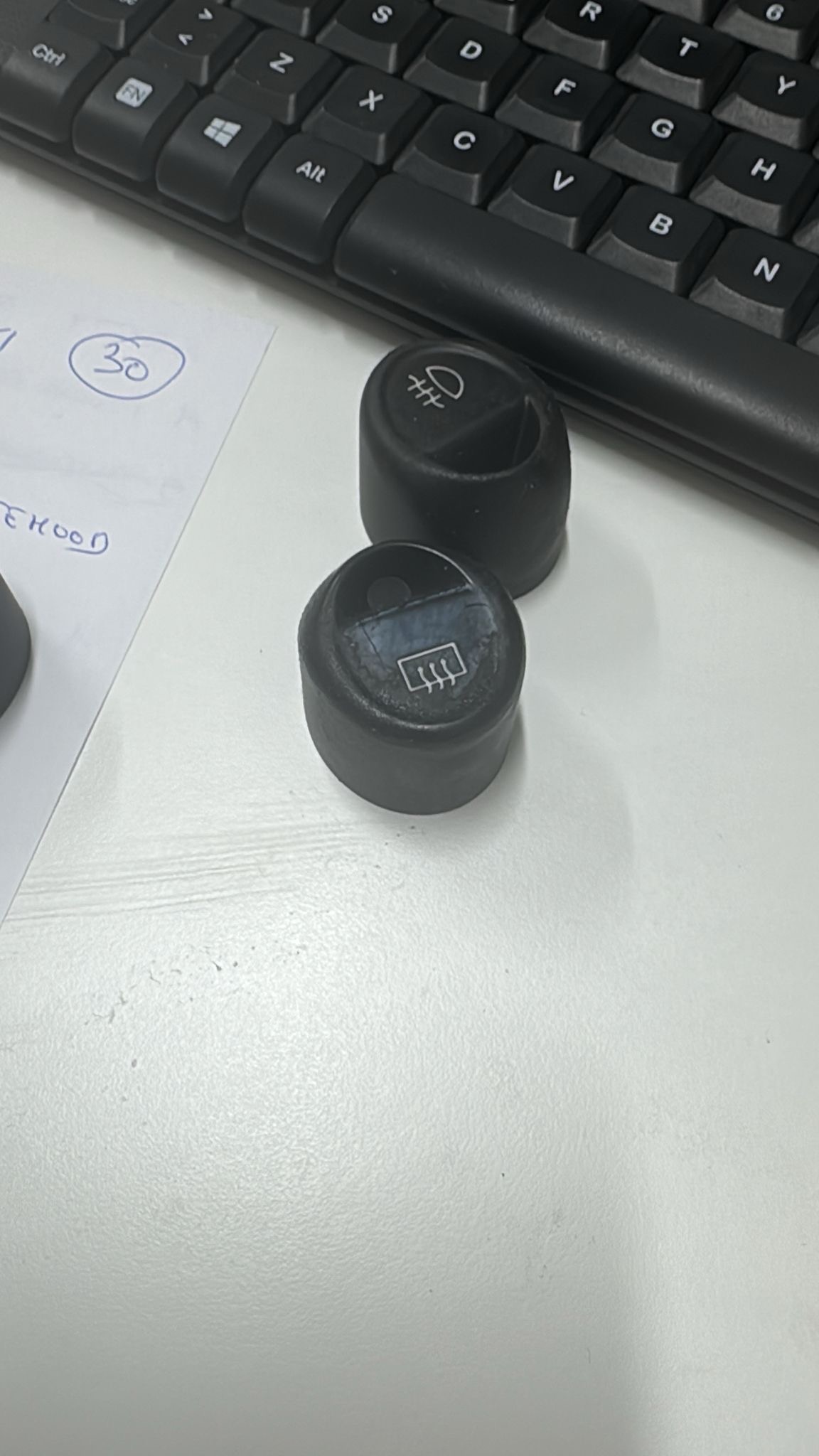

There is a product we use in Italy that you can buy online from Italian uk shops it called “Chante clair sgrassatore”. You can spray it on a microfiber cloth and it will melt the rubber easily. The buttons will thank you look kind of white, but with a pencil rubber and a bit of elbow grease they come good as new. See pics attached of the product and before and after.

The photo of the reassembled panel looks great. Very nice job! (y) It's interesting to see that the illuminated symbols are unaffected. Somebody once told me that hte "rubber" coating (probably Santoprene) is clear, but Ididn't believe them. Perhaps it's true though....
