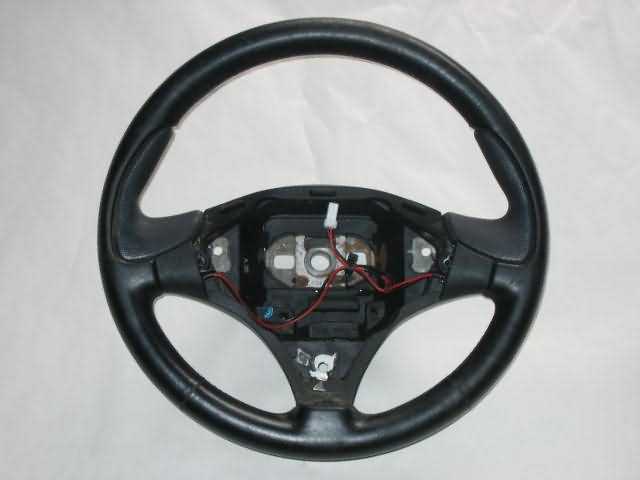

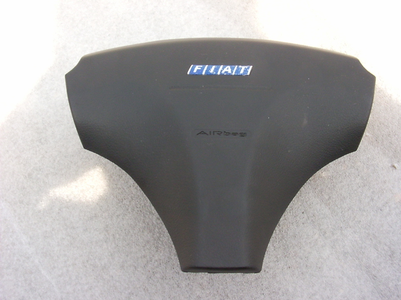

Its easy to change (y) A few screws on the back of the wheel let you remove the airbag. Once the airbag is off you can remove the wheel without any problems. Make sure you remove the + cable from your car battery first.
You can get a replacment leather wheel from ebay. A fiat coupe wheel is the same as the B.
Actually, it looks like two plugs - horn and airbag (yellow).

So the actual airbag is separate from the wheel?

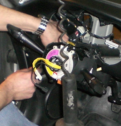

When pulling off the steering when be careful, make sure you have fed the wiring for the horn and airbag through the wheel as when you pull it off can pull/pop open the Spider/Spule (as shown in Robots pic). this has a very long length of wire wound up in it and it can shoot out easily, it is very hard to put back together...... a replacement can cost you £60 on ebay and around £200 from Fiat UK
