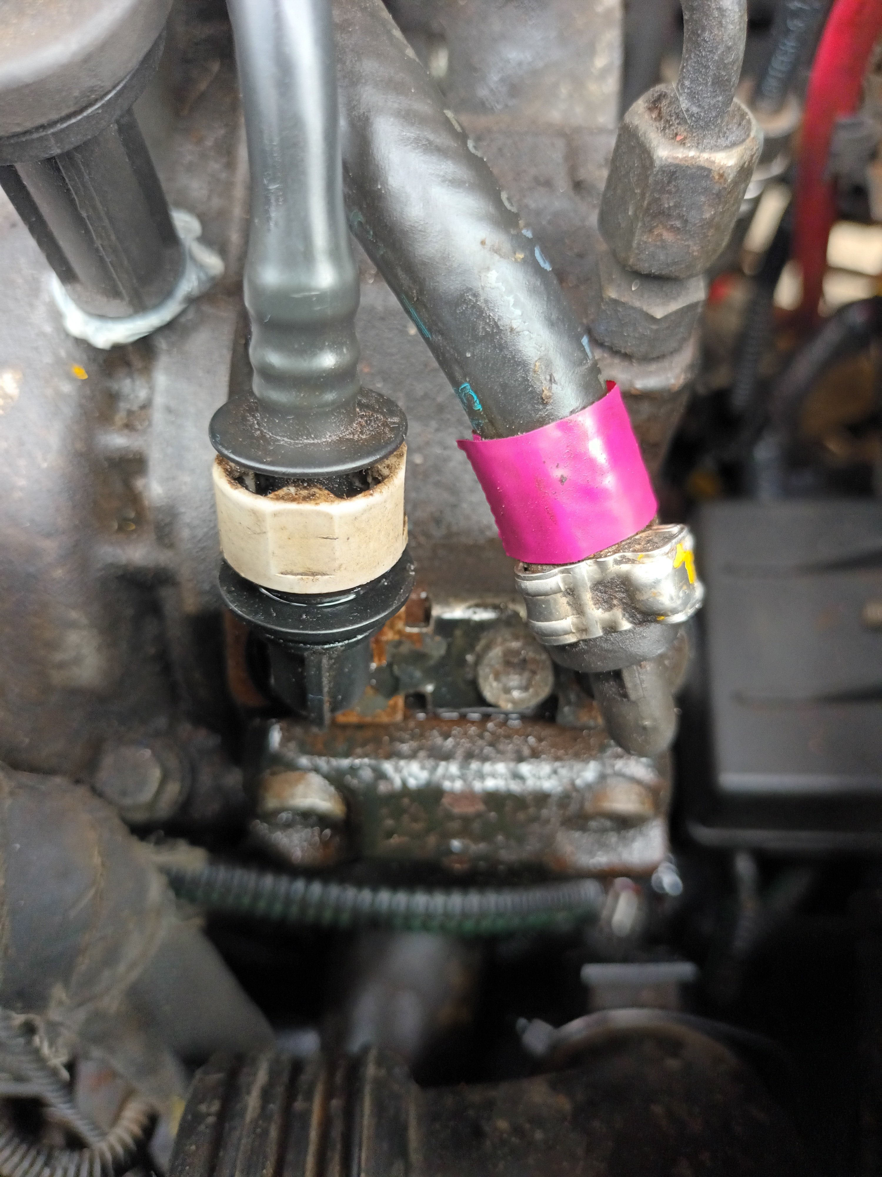

Have aleak at the elbow of the pipe with the white connector. Took elbow out to see o ring size nothing available. when I put it back in the van tyrns over tries to start then dies. Do I need to crack the pipes to injectors to bleed air. If not any ideas what's gone wrong .

Still have a diesel leak on the elbow below white connector. Fiat no longer stock this part and mot due in a couple of months. Has anyone got one for sale from a breaker . Thanks for reading .
Does it fit to engine with a screw/bolt?
Looks like we might have to improvise
Have you got a picture of it ? (apart from the one installed)
(or is it a bolt in itself)
(or the original part number)
Sorry for the delay in getting back to you the leak is from the elbow where it locates into the pump. The o ring looks slightly deformed so I have put a little packing similar to garden twine under the o ring and reversed it's direction. It does seem more secure in the hole . Will give this a go and hope it works . Pic of the elbow attached. Small clamping plate holds the elbow against the pump face .
Wow. That was some find thanks very much. Will get on to autodoc and order one . You're a top man ZaphodB
I must admit .... (and I'm giving away a trade secret here😜).... the power of "lens" within my android phone. (It's why I was asking for a photo in post 5)
Take a photo, or transfer it to your phone's photo collection (via whatsapp or whatever) , then click lens and look over the results (which is what I did.
There are several suppliers , most about £39 (with a confirmation photo) , but one or two at £20 (without the photo for confirmation , but is listing the same bosch part number)
