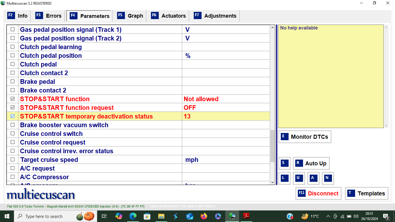

I used MultiECUscan (MES) to assist me in trying to get the Start-Stop working on my wife's 500S Twinair (85PS) . This after I had eliminated a battery and battery sensor issue . It seemed to point to some thing with the clutch released or the gear in neutral signal.
I had read the FCA e-learn guide on start-stop that is very helpful
https://lab-aftersales.fiat.com/ele...AND+RECHARING&nodeID=312008844&nodeName= STOP
The parameters for the start-stop system working showed "on" and "not active" it just wouldn't stop. The parameters were the same as on our other 500 where the start-stop worked OK.

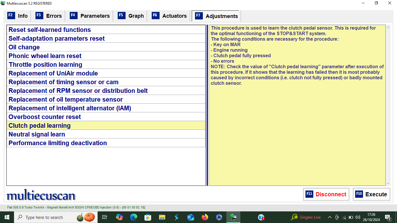

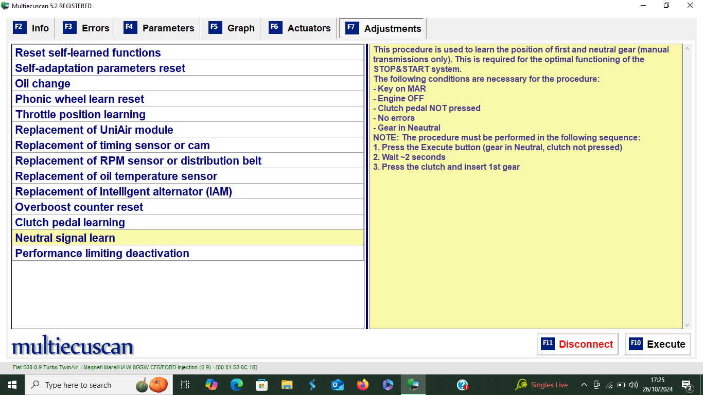

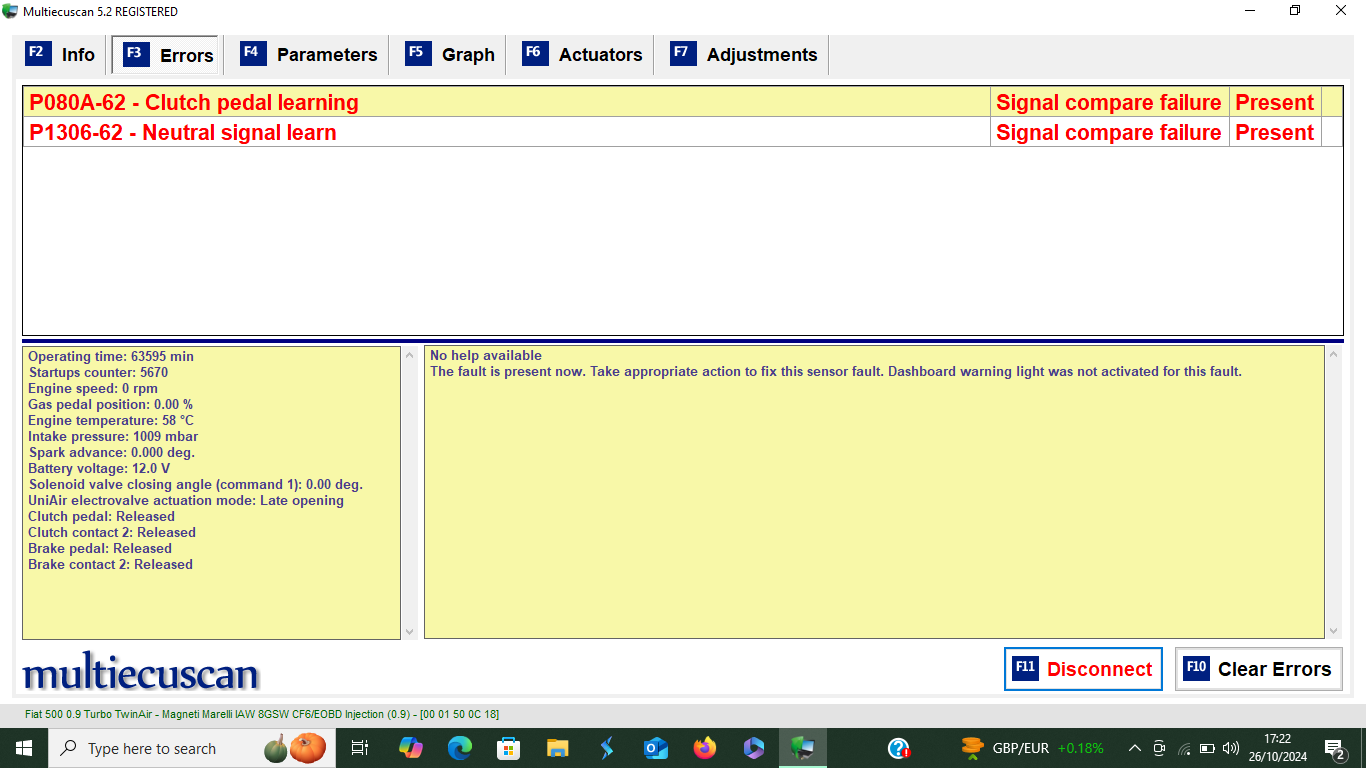

I noticed the clutch position sensor showed 1.5% when the clutch was released and I then noticed in the adjustments part there was a "clutch position learning" and also a neutral gear learning that referred to it being used for start-stop . I then carried out the procedures but it brought up a warning triangle, engine fault light and the message "start-stop unavailable" on the instrument cluster instead.
But then I couldn't restart the engine at all . I tried to clear the errors but they stayed "present " . I tried the procedures again and disconnected the battery for 15 mins but no joy ,
So I am now stuck and unable to start the car at all with the key , never mind about start-stop not working!!!
Any ideas on how to reset these parameters/errors in the ECM from MES or other .
The parameters for clutch released and gear in neutral (not reverse) indicated correctly too.

I had removed the start relay T20 and bench tested it OK, also start fuse OK . That brought up the appropriate fault code that i could clear when the relay was plugged back in .
Searching the internet on DTC P080A confirms it is the clutch sensor alignment and one youtube clip states that it could block the engine from starting.
This 69 plate 500 requires the clutch pressed before starting . So I am pretty confident this is what is blocking the start because the ECM is not getting the signal to say clutch is pressed . Our older 500 does not require the require the clutch pressed to start
I just need a way to reset the fault and/or carry out the sensor learning. This issue is self inflicted by me trying to carry out the clutch learning. I am wondering if the MES procedure is not correct, at least for this model software version. I don't think there is a hardware issue

In regards to the start stop system. MES showed the clutch position value from 1.5% fully released to 99% when fully depressed , but after I did the clutch learning it now only reads 89% when fully pressed. Maybe the timings in the procedure are wrong as MES did say complete on screen in less than 2 seconds
