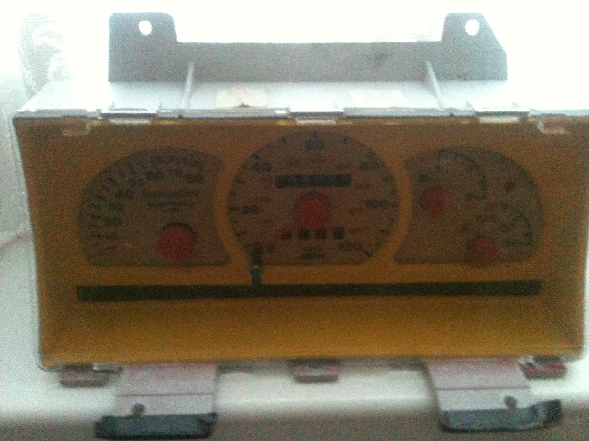

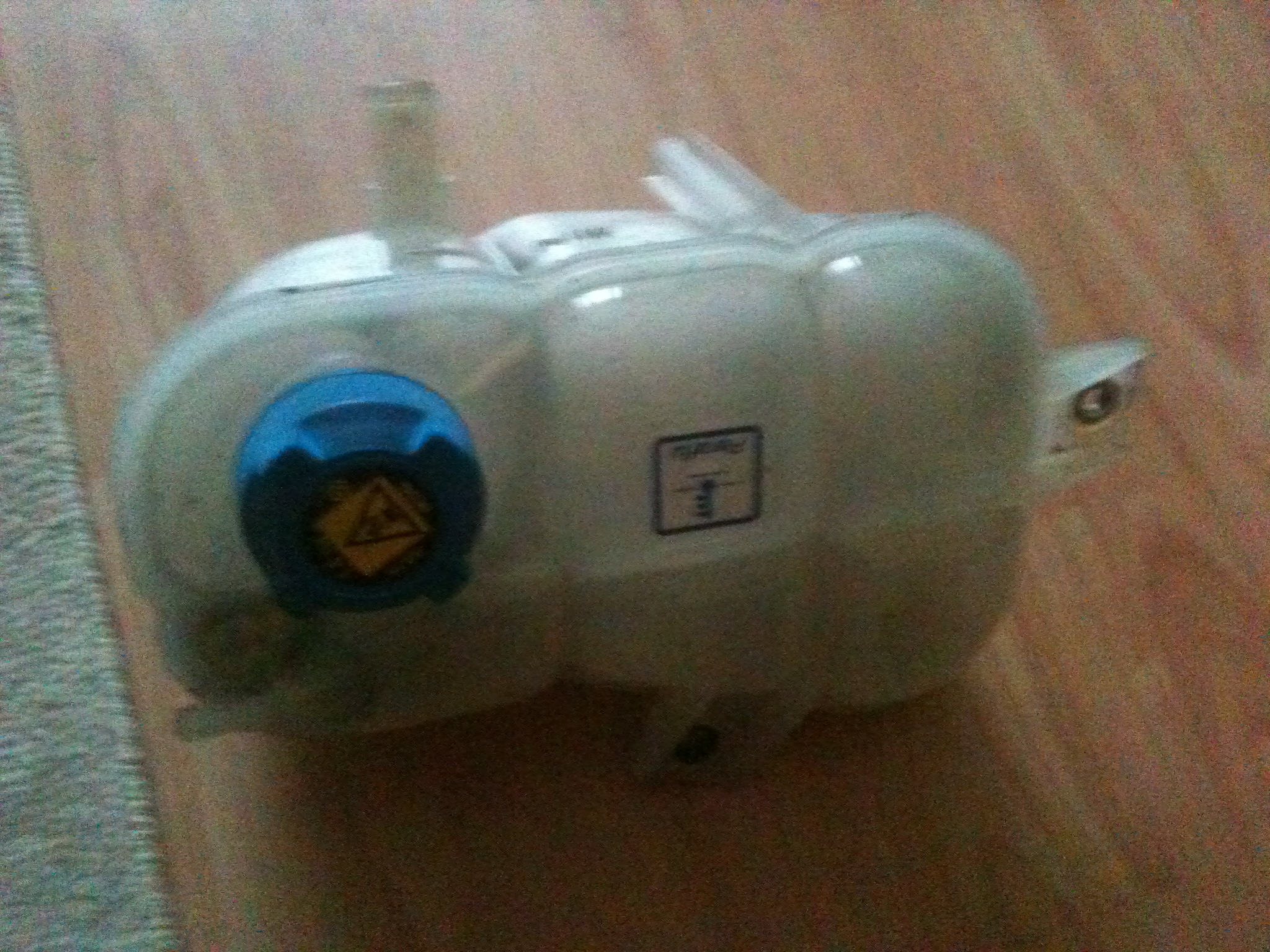

Also have bought a few more bits from dan and also another set of dash clocks WITH a code light (y) and also one of the thermostat housings with all the temp take off points etc....99p :woot: and the thermostat works perfectly (y)
